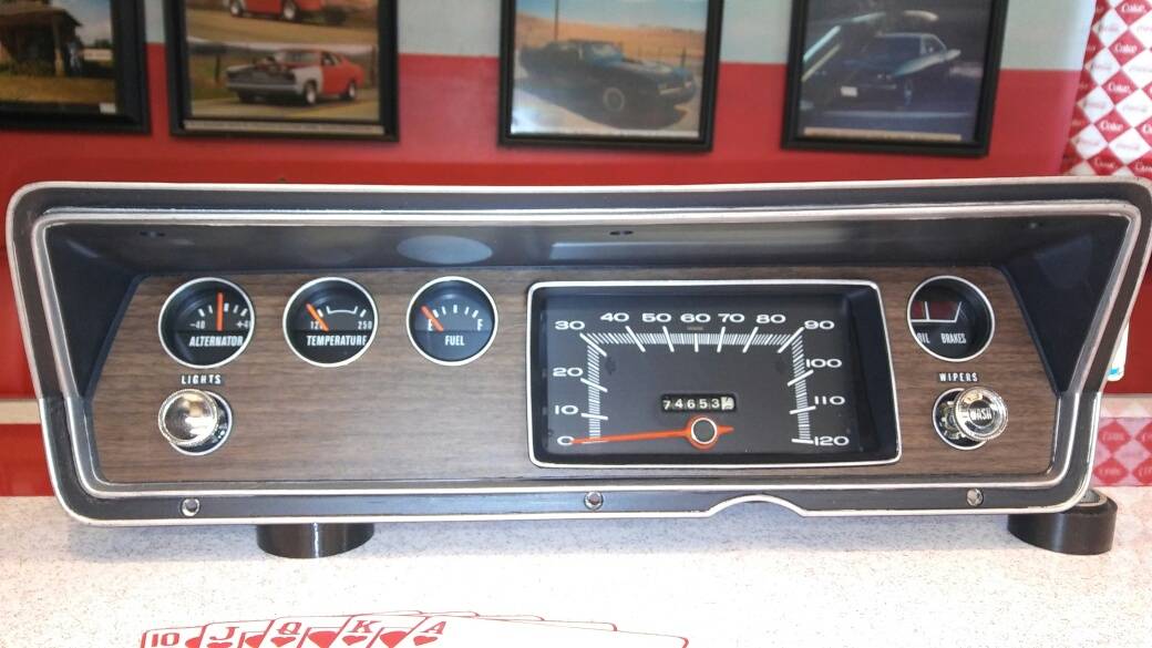

To paint trim ;
Hand sand the bezel with 320 grit or finer paper all areas which will get the flat black background paint. Wash thoroughly with warm soapy water, oils from your hands will cause problems with paint sticking to the surface. Carefully mask off areas where you do not wish to be painted the flat black ,like the factory did. I use 3M green automotive tape. Paint those areas you just masked off with 3-4 fine coats of the flat black, waiting 5 minutes between coats, it dries very fast. Leave masking tape on, as next you will hand paint the silver metallic on the raised trim with that paint stick applicator. Shake the applicator regularly and try a sample area before attempting the bezel trim. Go slowly and evenly across the trim areas. If you make any mistakes, you can touch up using the same paints here and a fine artists brush. If you need a new wood grain background, DMT, (Detroit Muscle Technologies), on E-bay makes an excellent laminate for that for under 20 bucks.

Note; The 1st picture in gallery below is a visual aid when painting trim on instrument cluster bezels.The 2nd, 3rd pictures in gallery below are visual aids to make your own turn signal lens or brake/high beam lens. The last picture in the gallery below shows the Testors paint stick applicator.
