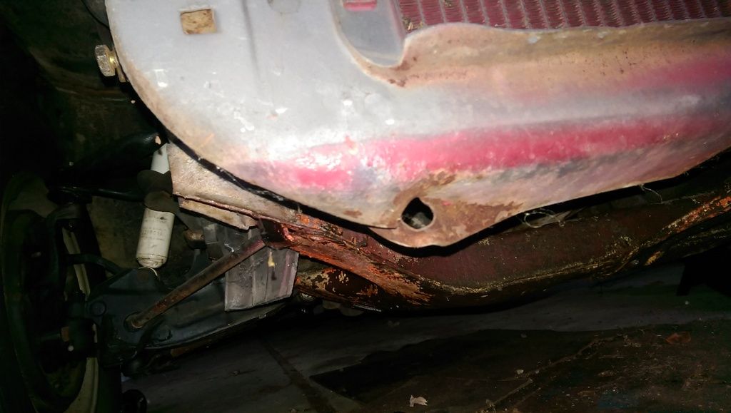

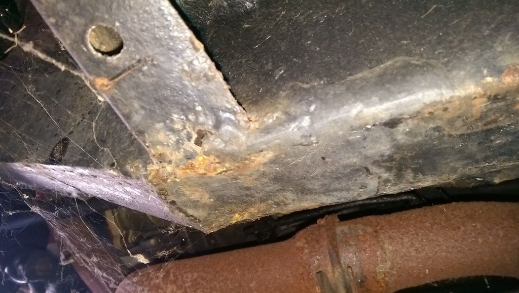

There is quite a bit of frame rail rust front and rear which will need to be tackled eventually by either full replacements or fabing something myself.

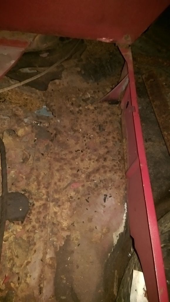

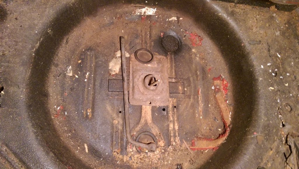

The trunk and underhood areas have a surprising amount of mouse turds. I was expecting a lot of rust in the trunk but found only the areas on top of the frame to have any and the extensions and well appear to be solid. The car was rear ended shortly before I bought it by a Mitsubishi Eclipse that the failed to put the hand brake on, the speed was low but the damage done. There is if I recall some damage to the rear of the frame rails, I was unable to get a good look today, they may need to be patched or replaced. The trunk was for an unknown amount of time without a functioning seal which I replaced almost immediately because it sat outside for the first two years I owned it, without a cover (it would have been stolen if it was covered). However; upon looking at the tire well I was surprised to see the body plug removed and the top of the tank wet (wasn't wet when I parked it). A look under the showed a gooey puddle on the ground and a streak on the tank.
Driver side of trunk
Passenger Side of trunk
Tire Well

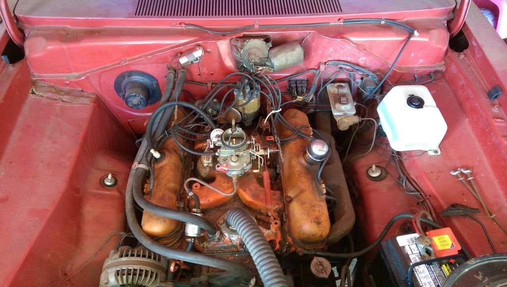

Obligatory engine shot with inner fender damage visible. Passenger side is split just in front of the seam and drivers side looks to have been eaten by battery acid as the hood it missing paint and the battery tray was only vaguely present when I replaced it.

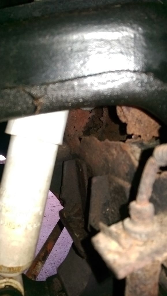

This weekend I need to get inside the wheel wells to look at the UCA mounts and tops of the frame rails, what I can see from the rear is not promising.
Bottom of Frame on Drivers Side doesn't look too bad and sounds solid

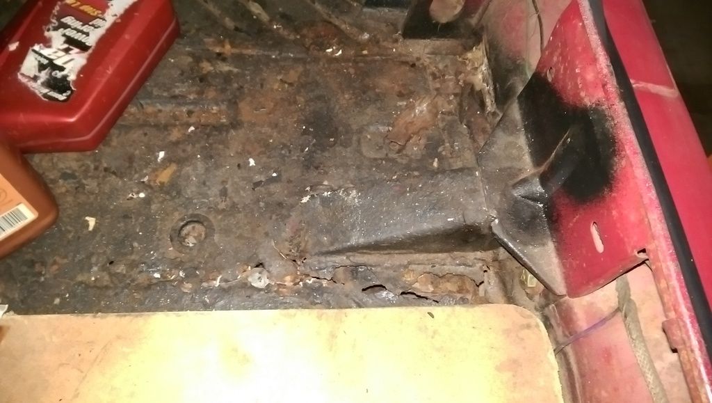

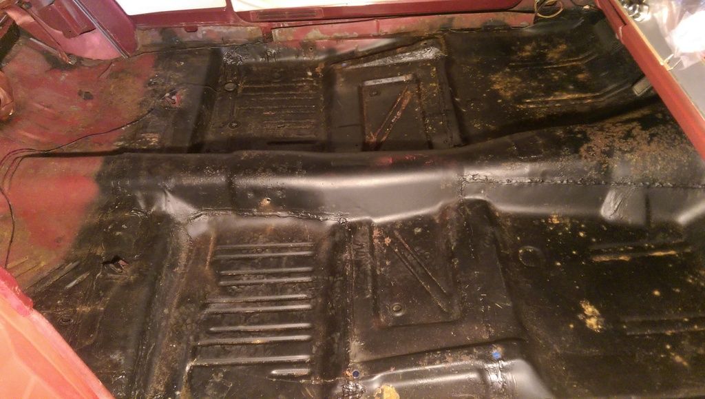

Spent some time out with the car today and surprised the wife with the progress. I removed the seats, found the rear bench was not bolted down. Got the carpet out and the rear cargo area. The front and rear floor pans have been replaced at some point. Won't be sure of the quality of the work until I strip the paint and sealer, but an relieved to find mostly solid metal from the rear seats forward. Hopefully this means I can move forward with replacing the front rails sooner. Behind the rear seats is a different story. The passenger side has a hole about the size of a baseball right above the frame rail, which appears to be capped. :banghead: So now it looks like the front and rear rails need replaced, this will be a great learning experience. I did however find a box with four ralley wheel center caps I didn't know I had and some other small parts I ordered years ago!

Thanks guys! This has been a long time coming, as stated earlier originally my plan was to get it drivable again. After a semi thorough inspection that was not an option with the upper control arm mounts about gone and what looks to be all of the trans fluid and engine oil coating the bottom of each, along with the gas tank and absolutely no brake pedal resistance.
The inspection did reveal that both of the rear quarter panels have been patched as well, the stickers are still on it but couldn't see who they were from. There is what appear to be about an 1 1/2" overlap on the inside though and the bottom of the weld is not painted to well, I will most likely spray rust encapsulator under the seam then fill it with seam sealer. The rockers also appear to have sort of work done, will not know to what extent until the paint comes off.

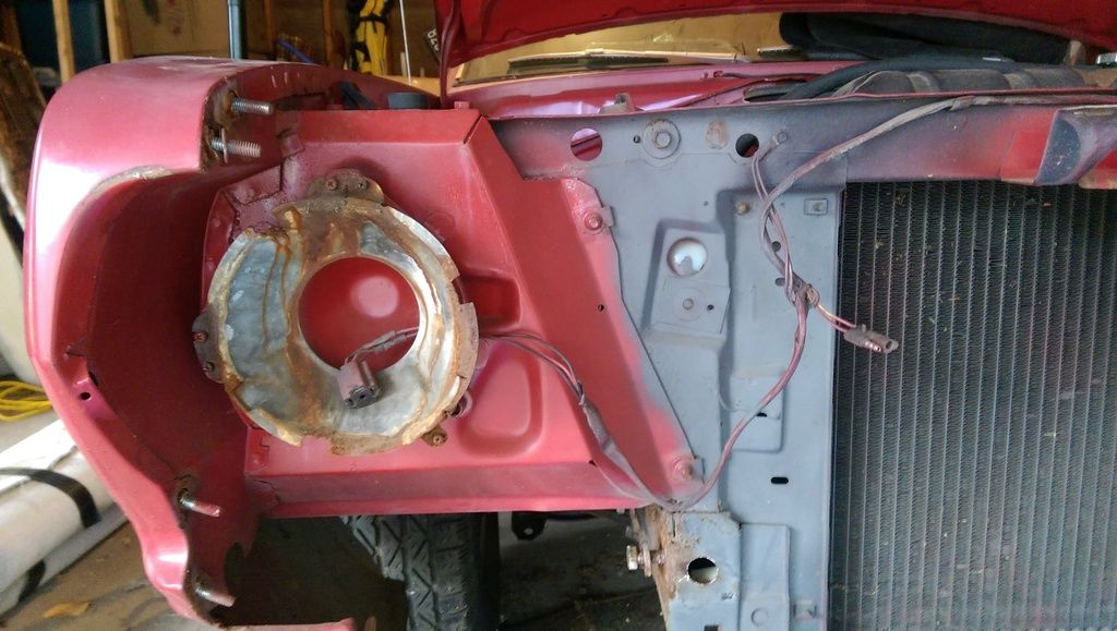

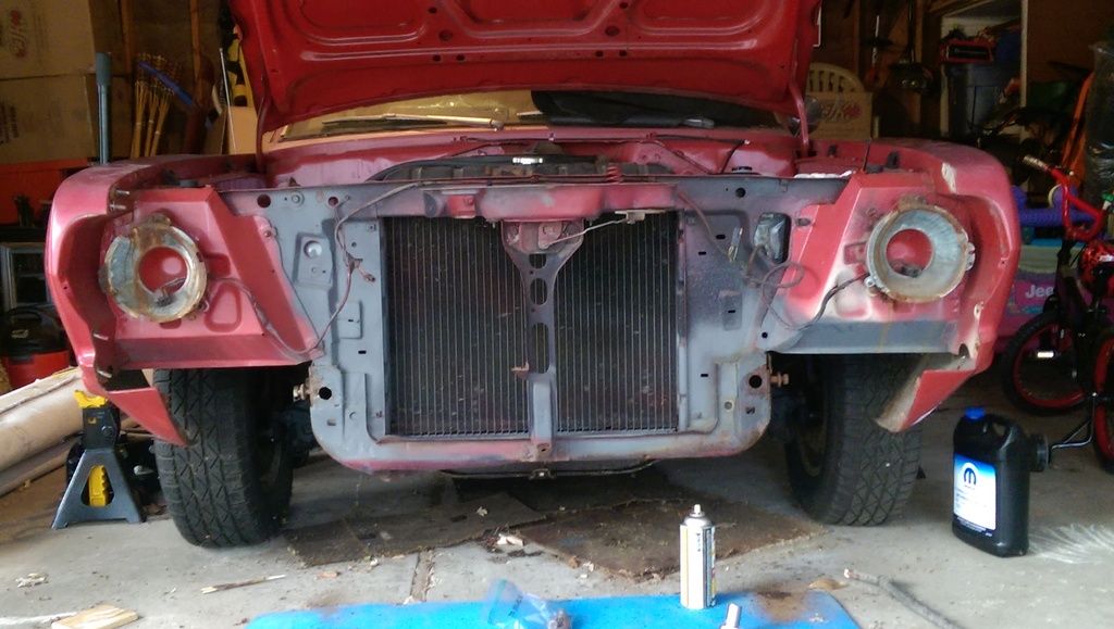

Got ambitious last night and started to remove front end stuff, it started out as let's see what behind the grill looks like, but turned into every thing but the fenders and hood came off. All while watching my two year old and keeping her in the yard.
I ended up having to leave the passenger side light attached as the po used a carbon steel screw to attach the headlight surround and it was hopelessly seized. Next came the lower valance then bumper, not the proper order I know, not sure what I was thinking.
Is there supposed to be a large gap between the fenders and the header panel on the bottom?
Next came the header panel, which had 2" hex head bolts inside the fender on the passenger side. This is the crap I am dealing with though out the car so far. Notice on the second picture the lean of drivers side fender, they never bolted the bottom to the rad support. The fenders were also not attached to the valance so every time you closed something, ie a door it rattled. :banghead: I stopped counted how many fasteners are not present already.
The lower radiator support is going to need to be replaced, it is solid but bent, I may fab a stronger one up when I get there.

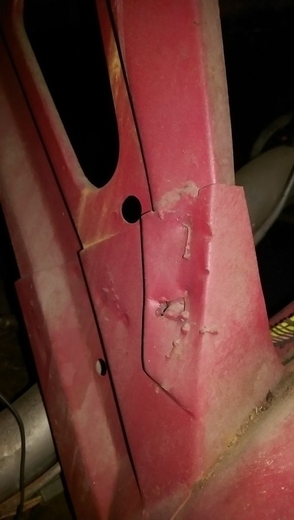

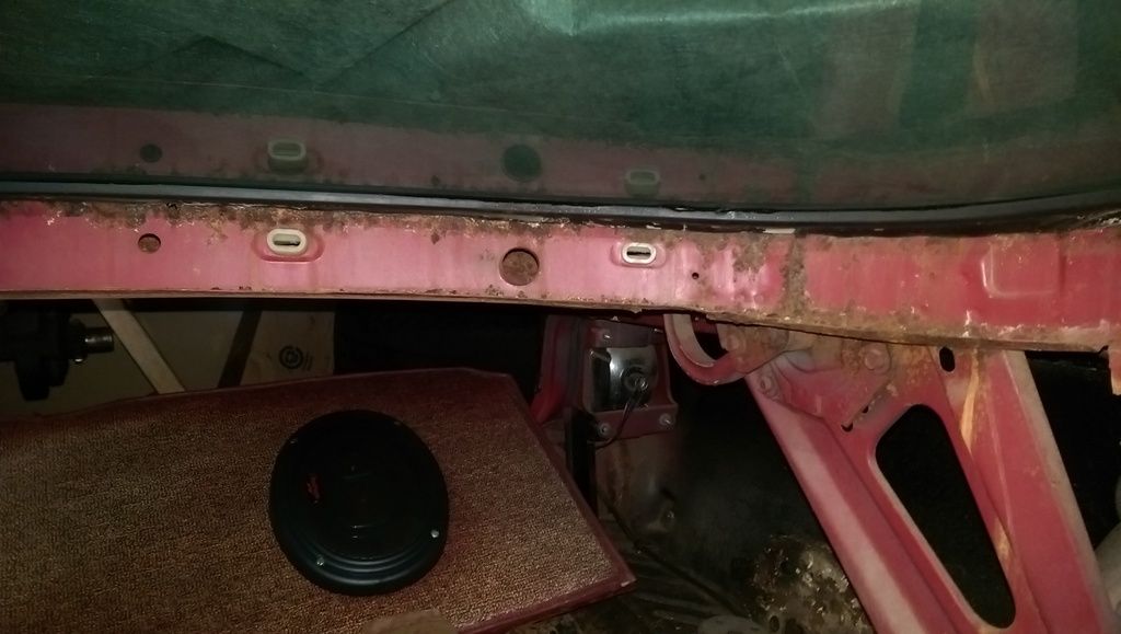

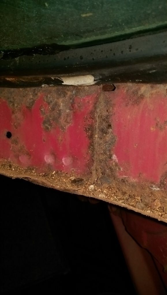

Forgot to add, a couple days ago I finished pulling the rear trim out. Most of it is in decent shape, the passenger side reveal is pretty rusty on the back, I am not sure it can be saved. What it did reveal is kind of what I suspected. I knew the hole on the trunk had to come from somewhere and that gravity and water always win. I was fully prepared to find the rear glass held up by duct tape and bailing wire. What I found was a few spots of rust along the lip of the trim, wont know truly how bad until I get the glass out (which scares the bejesus out of me to think about). There are some holes and it will be a good learning experience making the patches. The glass was caulked and siliconed in several spots inside and outside. Since the gasket is most likely toast I may be switching to the 68-69 style.
Also found an awesome welding job on the support brackets, not sure what the proper nomenclature is for it. Also found that the rear fenders were patched from the door to the tail lights. The front has rivets and some welds but the rest looks welded.

Damn, that's a nice, straight, clean front end you have there. That little gap is on my son's '68 as well, so I would say normal. As for that little bend in the rad support, at least what you show, you can straighten that easily. There are aftermarket pieces too if you don't want to fabricate one. Right on, looking good!
Thanks, I figured with the bumper covering it, it shouldn't be too big a deal. I am more than likely going to be dropping a 5.7 in so I am leaning towards a stiffer rad support. Im sure some one makes one of those as well.
Check my build thread and you will see what you are in for with the rear window channel.
That support in the trunk looks like factory crappy welding to me. Have seen that many times. Yours is savable but its gonna take some fab work. :D
