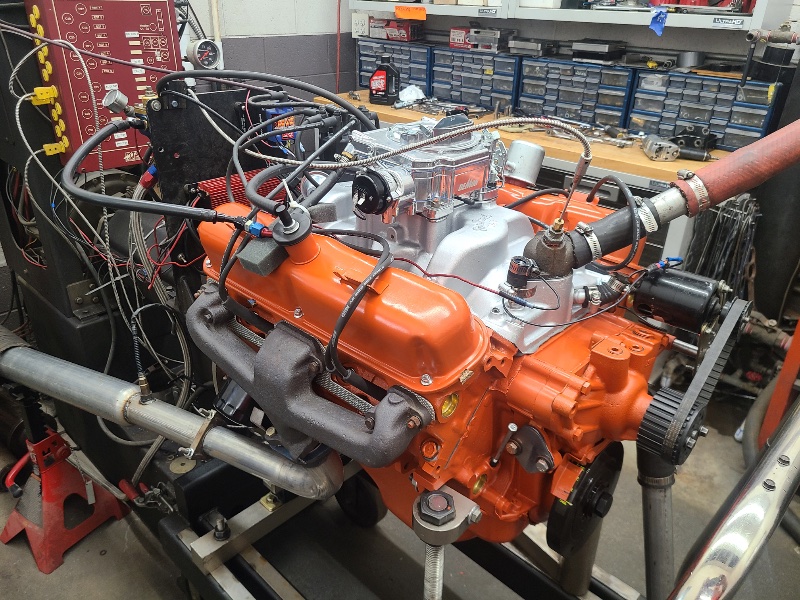

Does anyone know if the K-frame on a ‘65 Dart GT convertible V8 is the same as the coupe with a V8? Assuming they are the same but there are some additional braces on a convertible. If they are the same I’m thinking about using the K frame out of my coupe (which is on the rotisserie) to build up with suspension and my new engine and then install it all as a unit.
