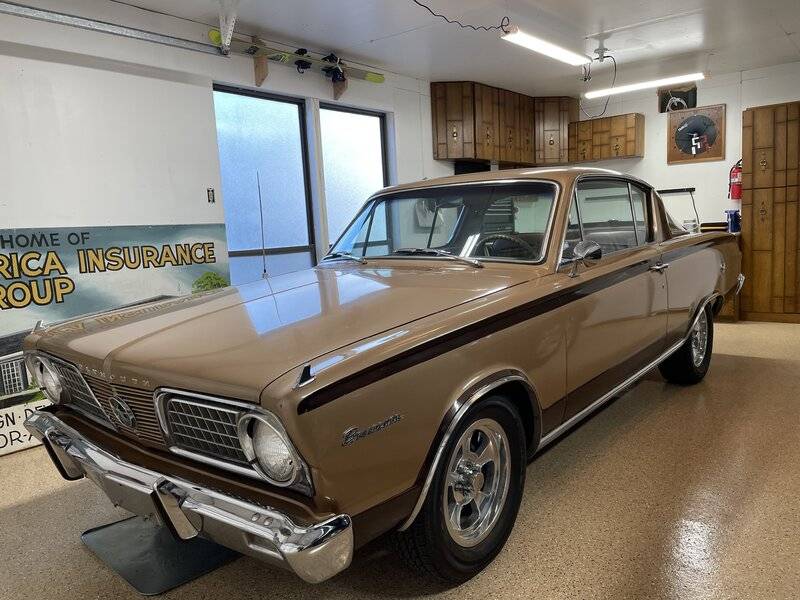

Hey all! New here and new to A bodies, but not new to later Mopars (mainly Jeeps). Picked up a modified 1966 Barracuda with a swapped in LA 360, A-833 trans, and 8-3/4 rear end (3.91 gearing). Pics attached for viewing / criticism

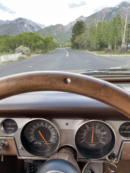

As the title states though, when I bought it the speedo cable was not hooked up (and now I know why). So I hooked it up to see what I’m dealing with. The odometer functions, albeit clearly not the right tooth speedo gear with how quickly if adds up, but the actual speedometer doesn’t work.
Curious if others have come across this before and know what I’m dealing with here. Is it a new instrument cluster entirely? Or does the gauge come apart and just something in there that I can replace?

Nice Car. Do you know if those rims are small blot pattern? Do you know who made those?
If odometer is clocking but not speedometer, then its internally broken. A speedometer rebuild shop can repair it, or see if somebody has a used replacement you can just swap in.
Yeah, that’s kind of what I was thinking. Guess no harm in taking it out and seeing if it’s something I can fix myself and if not, swapping in a replacement. Thanks for the reply!

Fear not, you can change the speedo out. I wouldn't try to adjust the mileage though, easy to break those.

All the other gauges seem to be in working order. I’ll look into some led bulbs though, thanks for the tip.
Somewhat of an update, driving it around this past weekend and the speedometer needle moved all the way to ~130mph, and then slowly came down and now seems to be functioning, albeit reading over what I’m actually driving due to the 3.91 gears. So not quite sure what to make of it now haha.
Chrome is in good shape though
