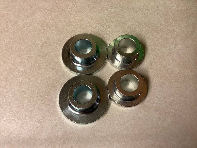

@HemiDenny , @DionR , @75slant6 , check this out! This is another Ride Tech product that come with their Mustang kits. It uses a S550 Mustang hub, so the bolt pattern is 5x4.5. They also have a caliper brackets that will allow the use of the S550 brake components. I'm not seeing these parts listed individually on their webpage, only included in kits. I kinda wish I would have found this earlier. This open options to use a factory Brembo caliper and have parts store availability for replacement parts.
FYI, I was able to order the hub washers from RideTech using the part numbers on their instructions. Kind of spendy at over $80, but now I have them.
The center bolt is just a 3/4” bolt, but the washers would have been more work to replicate.
