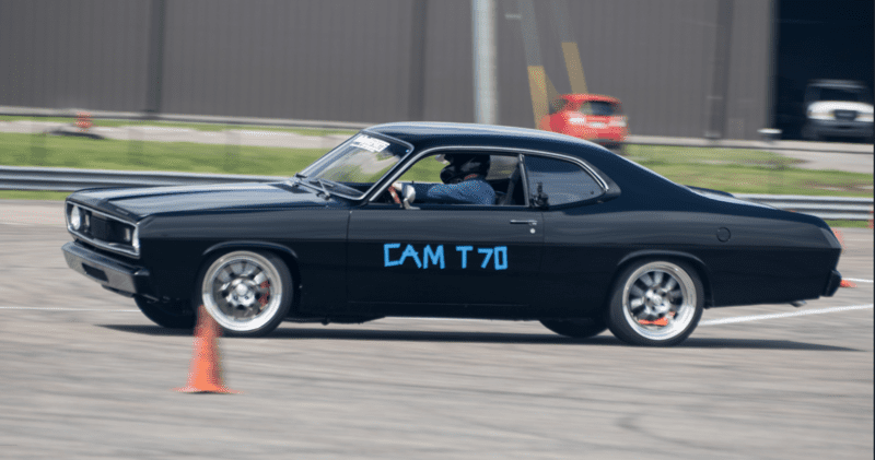

Hit the autocross this past weekend armed with my tire pyrometer. The picture below is a snapshot of a video my wife took. This was a 180 degree turn. Note how vertical the right front tire is. That looks pretty good to me! I actually think I have a touch too much camber or caster because the tire temps are slightly warmer on the inside of the tires. I deflated the tire 2lbs from my normal to let the tire flex more, which proved to have some improvement. Later in the day I attached a go pro to the quarter window which also captured my gauge cluster. I was going through the apex of this 180 degree corner at 30mph. I know it doesn't seem fast, but next time you are driving, take a 90 degree turn at 30 and see how it feels in your daily. There was also a 5 cone slalom that I ran through at 50mph. Cones were 30 paces apart, so maybe 90'. (Yes I pace off the slaloms when I walk the course to make sure they aren't decreasing distance.)
I'm thinking I may take .25 degrees of caster out before then next autocross to see if that helps any. I love that I'm to the point where I'm making such minor adjustments. Why did I wait so long to get a tire pyrometer?!?
You are fortunate to have consistent nice weather. Up here, it is in the 20's and snowing one day and the next it is 70's and sunny. At least the shop is a constant dry and 69 degrees.
Nice job getting dialed in.

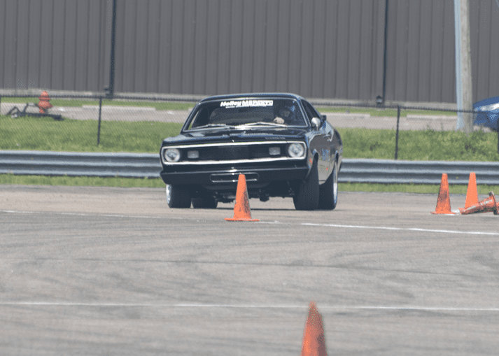

Here's a couple shots from the last autocross.
This turn was just before the one I previously posted. I like this photo since it shows how both front tires have good contact with the ground even with what looks like about 20 degrees of steering angle.
