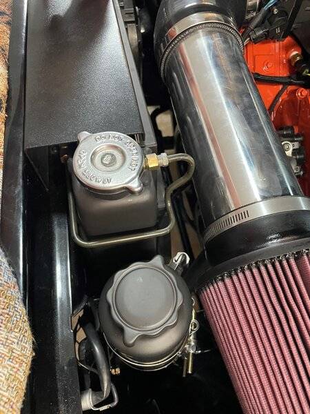

Knocked out some small items but otherwise didn't work on the car much this past weekend. I painted the Cerakote on the radiator overflow tank and power steering reservoir and got each of them back installed. Power steering lines are done except 1 fitting at the pump. I did receive the Turn1 flow reducer and I also installed the pressure reducer from Sublime. I'm hoping the combination of those two items work with the steering rack. I received all the parts for the air intake tube and filter. I need to weld a 1/2" pipe coupling in it for the IAT sensor and I'll also make a small bracket to help support it. Once the welding done, I'll paint the tube with Cerakote.
I also made another throttle body adapter. In my first version, I had the center of the intake opening matching the center of the 90mm t-body opening with a bevel all around to taper it down to the smaller hole. This made some things very close on the throttle lever. On my second version, I lined up the bottom and simply beveled the top gradually going to no taper on the bottom. I didn't take any pics but I'll snap some if I ever take it off.
I'm about 50% done with my throttle cable bracket. I'll post up some pics when it's done.
Since I switched to a dual pass radiator to keep the inlet/outlet on the right side, that means the cap will be on the opposite side. This means I had to make a new steel overflow line.

View attachment 1716255513View attachment 1716255512

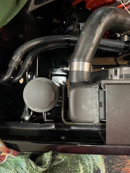

These gates shrink clamps are badass! So much better looking than a screw clamp.

How do the Gates ends attach? "These gates shrink clamps are badass! So much better looking than a screw clamp." I just did all the pfte stuff and I have no leaks but was a bit worried. I also cant seem to find the nice fasteners to hang these lines attached to firewall or to say the AC compressor holes for fuel line. Been meaning to look at your thread as I know you made this very clean and it sure makes a huge difference all that rubber crap gone. I ran an 6 from tank to carb and AN 8 for my ZF swap to cooler up front, what a huge difference! Also curious on master cylinder part number I am going to get rid of my power brakes and go with the 7/8 I believe it is unit.
Those aren't Gates ends on the heater hoses. It's just an AN to hose barb adapter. The Gates clamp is pretty much plastic heat shrink. Just slide it on and heat it with a heat gun. All of the fuel line and AN fittings are Evil Energy brand found on Amazon. It may be hard to see, but I have some aluminum separators on the heater hoses. I'm sure I got those on Amazon as well. You can use a rubber lined P-clamp to secure lines to something. I normally paint them black before installing.
