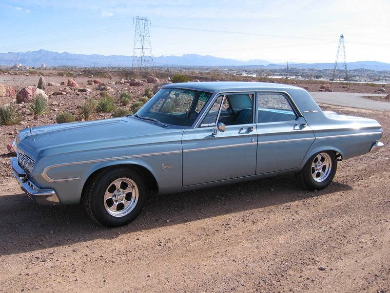

Just out of curiosity, does anyone have 16s on Their car? I am curious to see how they look proportionally.
not the best pics but it may help.. the 68 dart has 16" wheels. the 71 dart has 17" wheels.. a lot better selection when you get to a 17 or 18" wheel then with a 16..
I think its too bad there's not a lot of 16" choices they look right at home on muscle cars nice balance side wall to rim.
Those 17's look better anyway IMO and tire selection is far better.
The first photo are 16's the second photo are 15's hard to tell the difference. And yes they do look right at home on a old Mopar.
