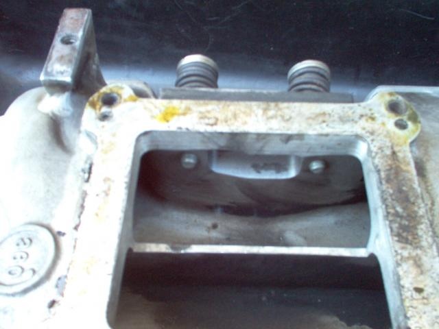

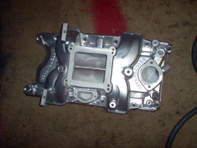

nice intake that must be the second gen dyers intake he went to the dual quad in line intake,, the oen i had was one of his first for a 6.71 single 4bbl in take with a plate and pop off valve here is a pic
Wow! I thought Gary used the dual quad Offy's from the git-go. That's interesting to see.
when i built that car i lived out side chicago,,,been to dyers shop a few times,, guy i got the intake from, went to the intake u have,,, my intake on his motor in a duster,,,auto all steel car 8 inch wide slick went 10.63

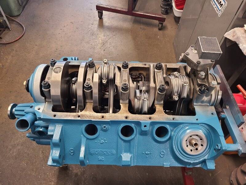

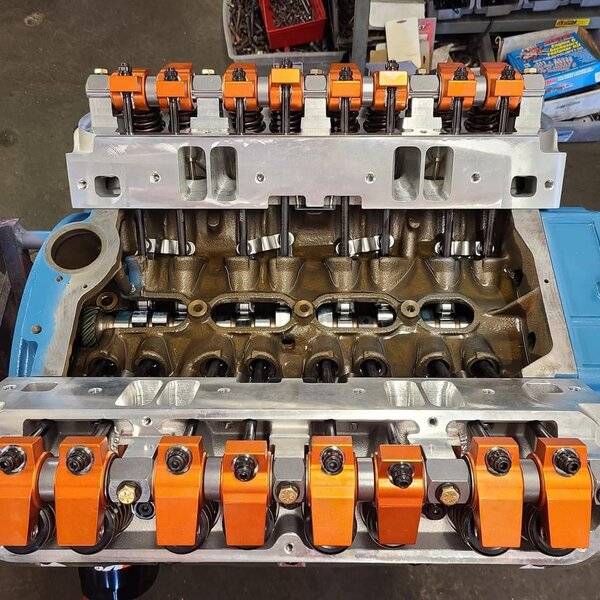

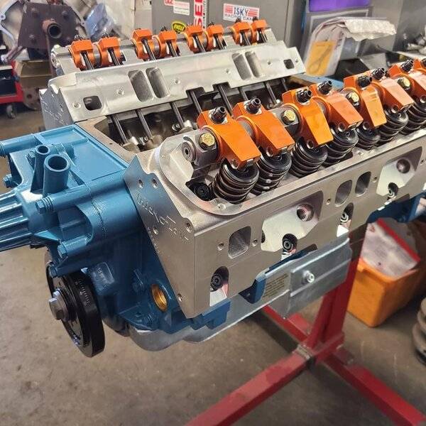

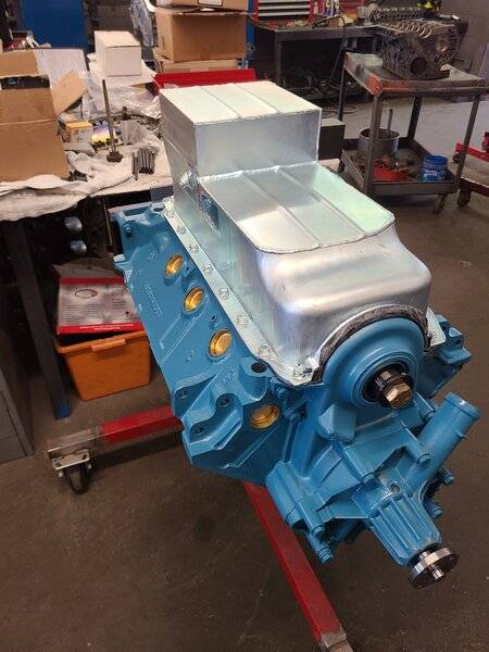

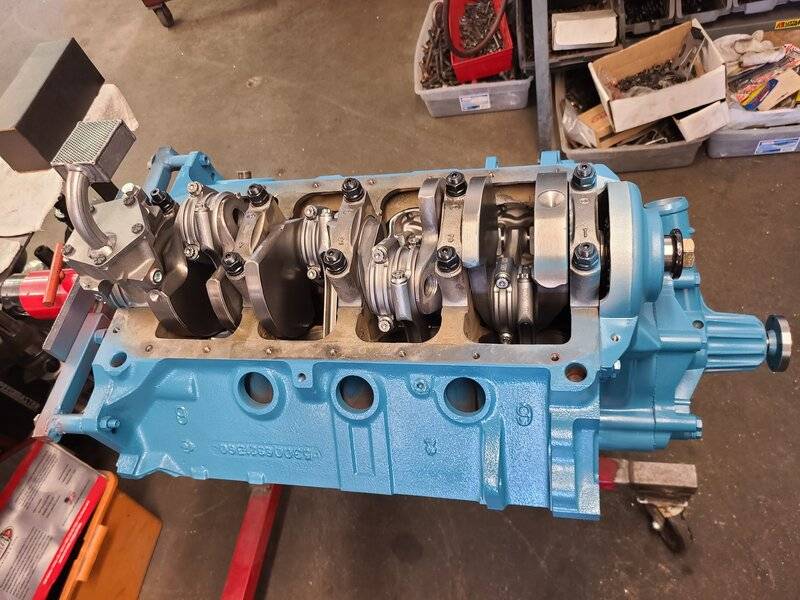

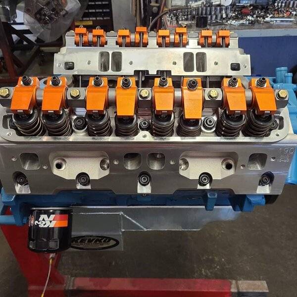

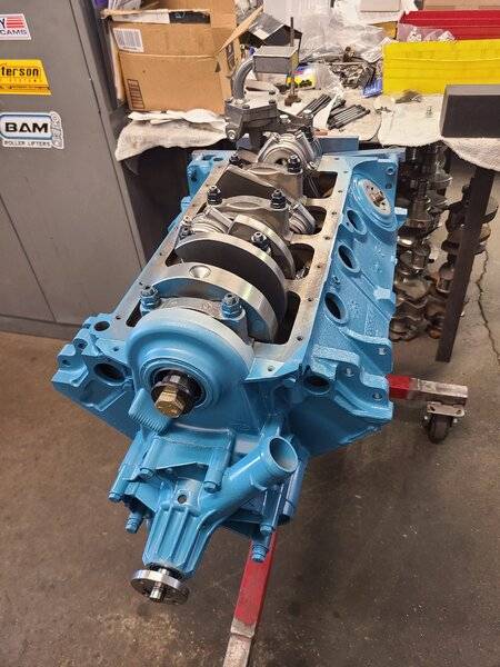

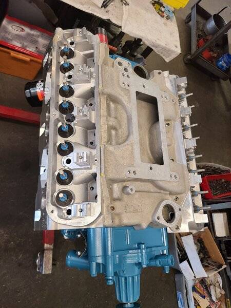

Man I started this thread a long time ago. I have an update.
‘89 roller cam 360 block .020” over
4” stroke Scat forged crank, H beam rods.
CP forged pistons 9.25:1 compression
ARP main studs, Melling HV pump, oiling mods done by IMM
BAM solid roller lifters
Cam .650 lift 112C/L 258? Dur. (I’ll get cam card)
Trick flow heads, Harland Sharp 1.6 rockers

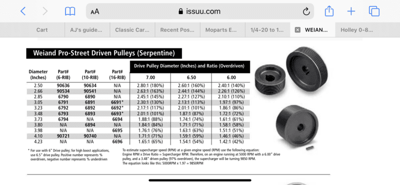

Nice lookin setup. What percentage are you gonna drive the blower?
Thank you. 6” crank pulley with a 2.5” blower pulley is 140% overdriven.
Good GAWD. They must not move a ton of air to begin with. That seems like a boat load of overdrive.....but I'm all for it. I've never seen the point in NOT USING a blower. I've built a few blown engines and using them is where it's at. I never have understood guys that build engines and then underdrive them.
I'm really diggin the #5 exhaust valve. That beeotch is some amount of OPEN! LOL
Yea I’ll be working that thing. 6500 Engine rpm is 15,600 on the blower side. That’ll make some heat! LOL. I had Brian go bananas with the cam. Lol
