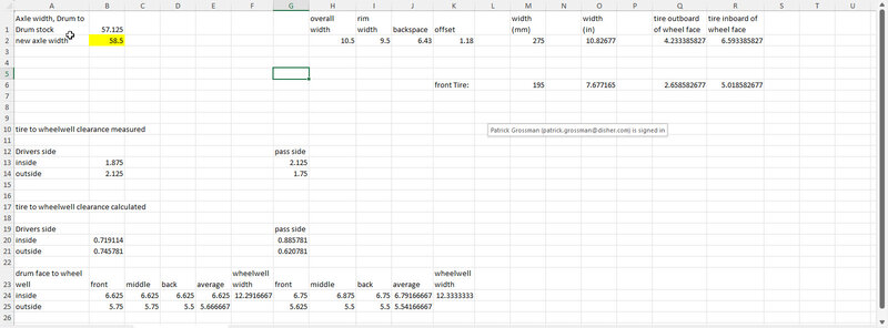

I've got a spreadsheet based on dimensions I took off of my duster that I can plug different backspace/offsets and tire widths. do you know the actual drum-face-to-drum face axle width?
it looks like for a +30mm (1.18") offset rim, a wheel mount face to wheel mount face measurement of 58.5" (stock width for a 93-09? ford Ranger, and you can find ranger 8.8" axles with 3.55, 3.73, and 4.10's with limited slip fairly easily and cheaply) will just about perfectly center the tire L-R in the wheelwell, leaving about 3/4" inboard and outboard clearance. of course, your mileage may vary.

As @michiganpat said, it would be just about perfect for an 8.8”. Would also be pretty close for a 65-67 B body rear.
