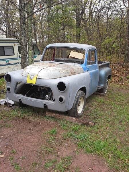

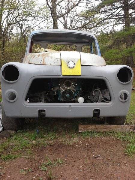

I used a 8-3/8 from a mid 80’s dodge 1/2 ton. Moves wheels out, but it looks less like a roller skate now. 3.55 gears with 265’s it spins at 2500 rpms at 60 mph.
I made cab mounts and used a 86 step side frame and bed has 8 3/4 rear and will accept big blocks. Fine threads are correct and 54 through 56 very much the same
Derrick,
I'd be interested in what kind of adaptations you had to do to get the wheelbase and body to line up.
Any pictures of the frame?
Maybe i need to PM you.
