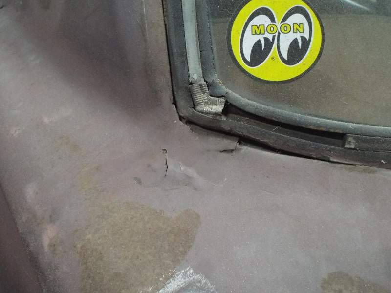

Pitchers as promised. Wire brushed the heck out of everything good. Then went over it with......you guessed it......Rustoleum. LOL Inside and out. Next I will make necessary repairs and another coat of my beloved Rustoleum. Once fixed, it will outlast me and "whoever" ends up with it next.

Been toiling with what to do next on the Valiant. So, I bit it off tonight. I went out and started removing the front windshield. There were a few swollen spots in the gasket at the top, indicating leaks. Also, when I rolled one of those spots back, rust would fall out. So, I knew it needed attention. Of course, 55 year old glass is fragile, needless to say. Yup, I cracked it. I kinda knew I would. It's just really difficult not to with one that's been in so long. Got it out and the pinch weld.....while has some damage, is not as bad as I thought. Extremely repairable. Pictures in a bit. I just hope a windshield isn't hard to find. lol

Keith, it was like it wanted to break. I stuck my FINGER between the body and windshield and rolled it out to get it started out after I cut ALL the gasket away from it and it cracked. lol So far, I've had no luck, but I haven't tried very hard, either. Besides, I'm not quite ready for one anyway. I have a bit of work to do now that I have it out. I bout knew it would break. I've done a lot of these through the years and most anything over 30 years old with a gasket almost always breaks coming out. Funny, the GM stuff held in by the adhesive roll stuff I can get out almost every single time unbroken. The little car's worth new front glass anyway. Hopefully I can beat the odds and get the rear out in one piece, because it has to come out, too. lol
