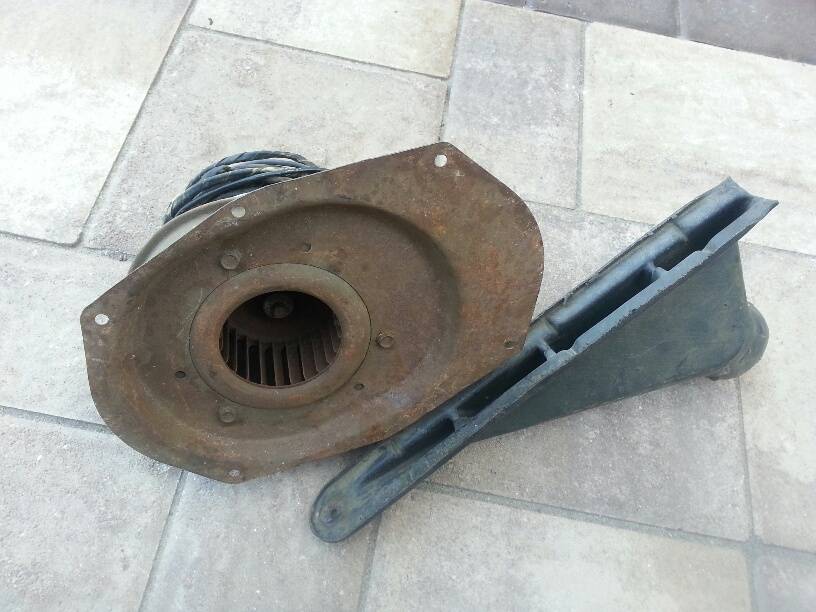

View attachment 1715094044 View attachment 1715094045 I want to use this defroster I found in some of my stored parts that I'm digging into is this correct for 1966 barracuda?
Hey Cap,,,
any chance you got the part number off that plastic vent piece?
the 66 parts book shows 5 defog kits with separate part numbers for each duct but they do not list which car they are assigned to.

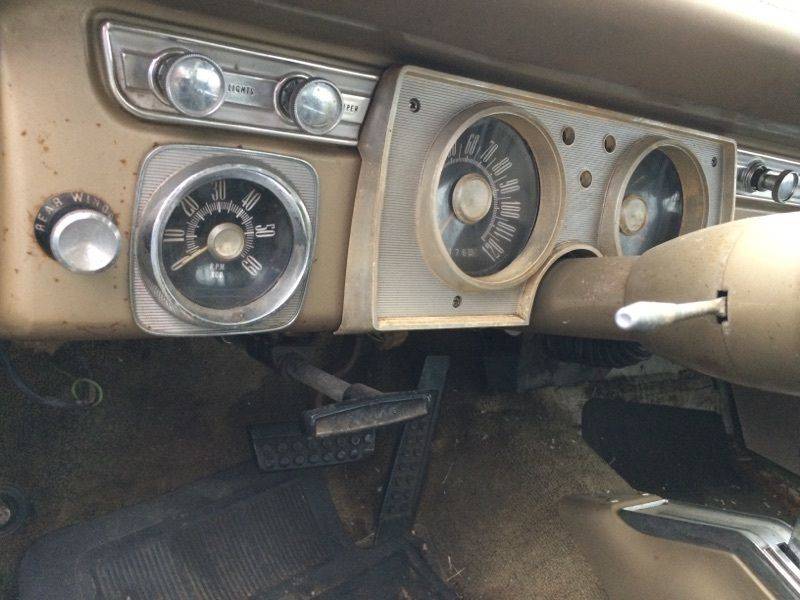

I have the dash switch (lower left) and the "speaker grill" but no blower and shroud. Would love to find though. The switch feels like Off-Low-High

I have one of those it includes the blower assy.(blower goes where the speaker would go right side) the vent and hose, if you interested let me know
