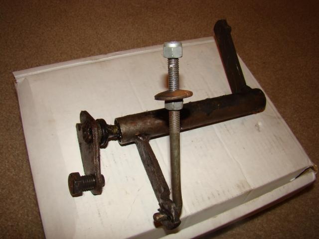

First, I can't be sure I have a correct 1965 dart pedal assembly. Its a hack job under the dash, I'll probably need professional help sooner or later, but... here's what I got. I'm working on electrical and seems like I'm hitting lots of snags.
I wanted to get my brake lights to work. There appears to be a 1" space between what I think is the brake switch and the brake pedal, when the brake pedal is at rest. This gap needs to be eliminated, but I don't know how it should be fixed.
Is my spring loaded brake switch not extending far enough? Do I need to weld or glue something on my brake pedal? The brake pedal, gas pedal and clutch pedal are all lined up very evenly.
I have a picture of this hack job, my entire pedal assembly has been cut in places and pedals rewelded, my steering column is notched so that my clutch rod doesn't hit, and I can see a bolt going from the disk brake plunger that has a hex end, and nut in the other side into a 3" piece of metal that serves as a lever, so that when my brake pedal is depressed it pushes the brake plunger and activates the power drum brakes of the 1974 power wagon undercarriage.

Wow looks like someone tried to re engineer your brake assembly with all the wrong parts. That bolt sticking out should go through the plunger without that adapter thing they made.

I learned something here. I think the fix to the adapter bracket is to take the plunger out and shorten it by a couple inches and then put it back in, and hook the brake pedal up the correct original way. This won't make the brake switch any closer. But overall this is probably the better way to go.

Ok with that last picture the yellow bracket appears to be a hacked up clutch assembly. If you are running an auto you can make that go away. Then as before the extension adapter that is on the end of the pushrod should be removed and the correct length push rod used.

The yellow part is a Z bar but off what I have no idea. It is normally mounted between the engine or bell housing and the frame of a vehicle.
Here is an example picture of one that is for an A-body.
