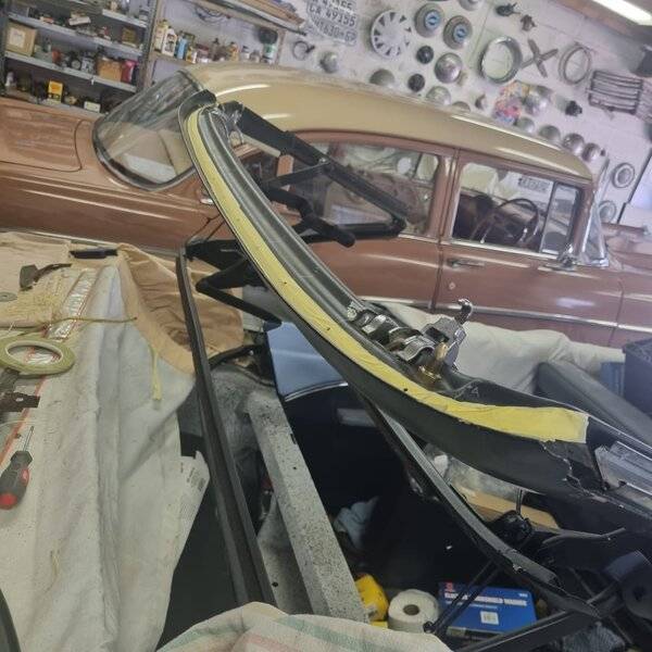

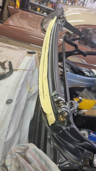

First a template was created by sticking masking tape to the the curved surface. The Curved surface would have a very different shape when flattered out.

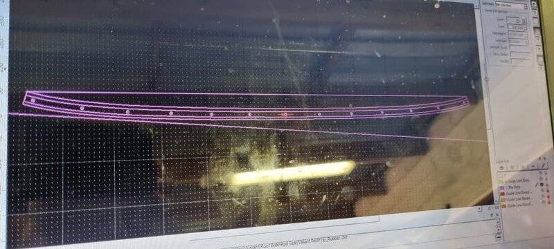

The Masking tape templates were scanned and turned into a CAD version.
This was then printed on paper, reinforced with layer of masking tape so the paper would not distort and tested.

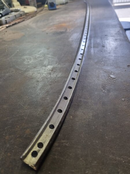

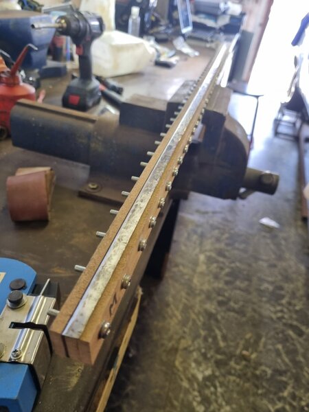

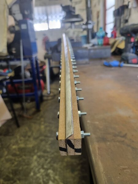

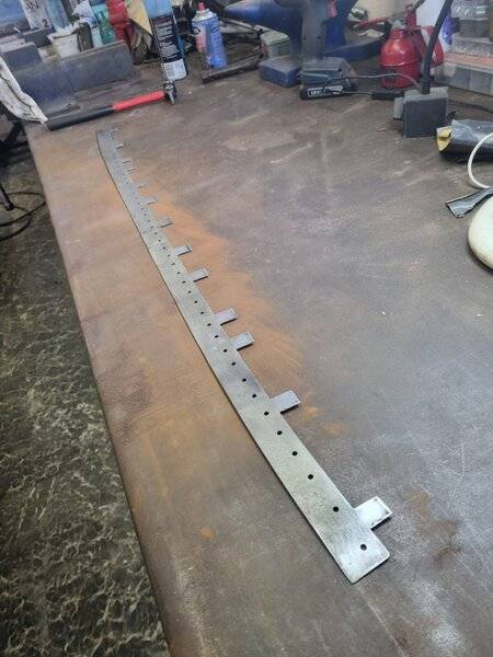

First the strip that holds the rubber seal.
From a sheet of 1mm plate, the shape was cut out and formed with the jig.
To end, the jig need to be broken out of the "C" shaped profile.

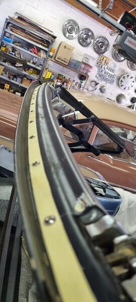

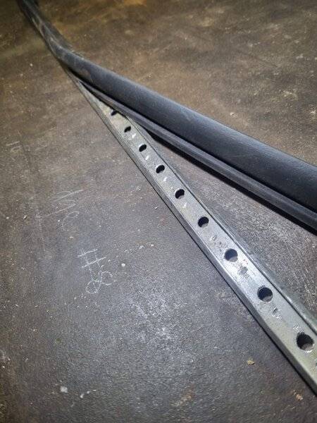

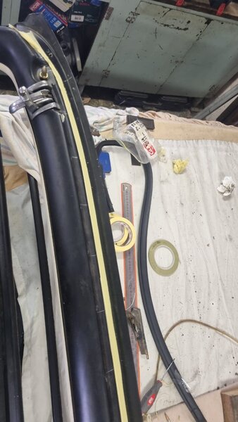

Testing to see how the profile holds the rubber bit. It does it well.
Then fitted to the bulkhead and checking how it all comes together at the windscreen.

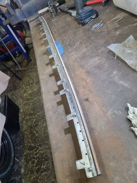

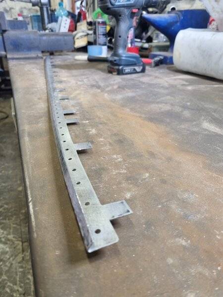

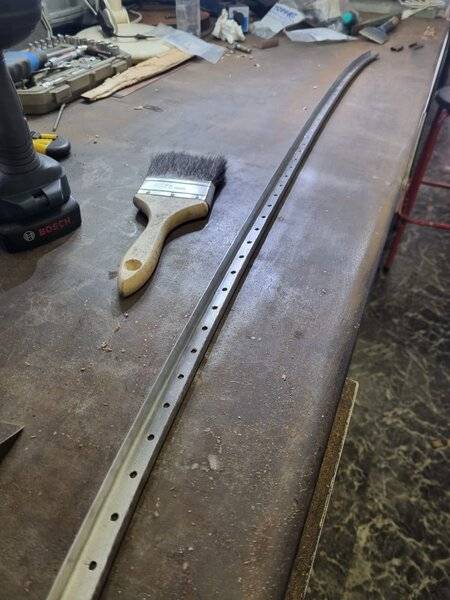

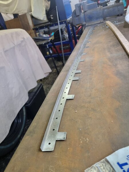

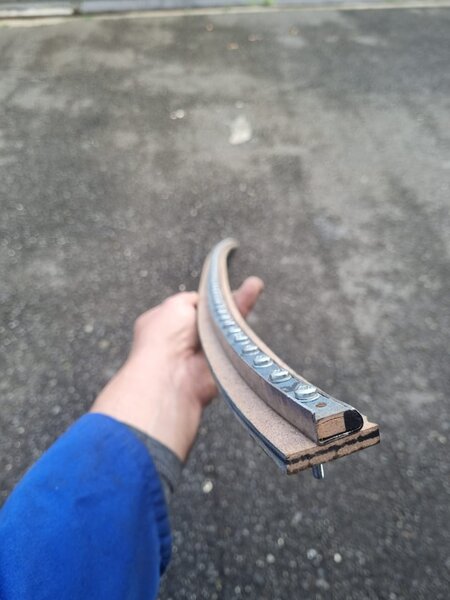

Next the part that will cover / hold the ragtop end in place.
To simplify the profile and to make the two parts independently adjustable, I chose to make this a separate part.
Again from a 1mm piece of plate.
Cut out roughly, trimmed to the line and formed.
You need to watch metal. It quickly goes out of shape, needing you need to bring it back to what you are wanting. After flattening the seam, there was too much arc in the shape, needing the inside curve to be streched to get it all back to the shape of the jig.

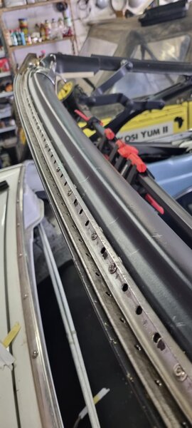

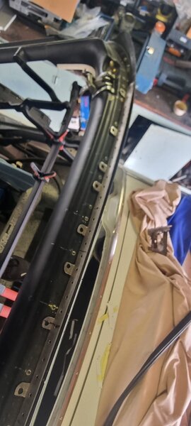

Ragtop part finished off and test fitted to the bulkhead.
The profiles are now held to the bulkhead with M4 screws and rivnuts.
All screwed together and checked.
It works.
Next the parts must go for plating.
