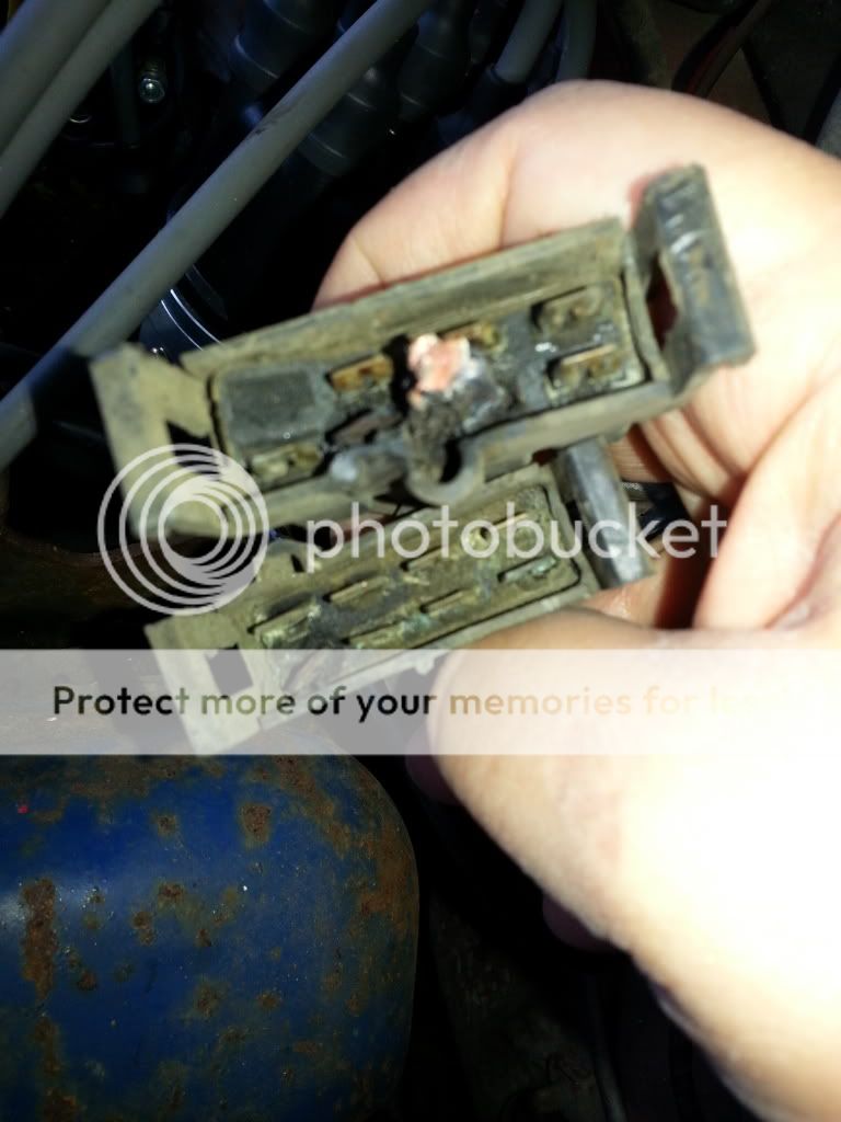

Unfortunatly, I hit a bit of impasse...but I'm back on talking terms with the iron lady. Looks like I'll need to find the following bits:
If someone can point me in the right direction that would be great....

The bulkhead connector is part of the dash wiring harness. I don't know who makes the connector in repop. It is out there somewhere as there would be no repop dash harnesses otherwise.
Year One has the dash harness 67 Barracuda for a cool $445.99 (HU306A). This harness connects everything but the steering column. Considering the past problems with the ignition switch and the value of your time, this may be a good investment.
I used YOs wiring for the Demon which was missing wiring from the firewall forward. Yes it's pricey, but I didn't have to ring out wiring and re-do half fast connections. Quality of the connectors and wire was good on what I bought.
the link I gave has the bulkhead connector listed in it. I agree with 2 darts though the YO engine lighting harness is affordable and a correct direct replacement for less than 200. I think I paid 145 for mine on special. I rebuilt my dash harness.
Bulkhead Connectors
66-74 A Body bulkhead connector $70.00
the terminals are "packard 56" type. Napa carries in the weather pack catalog.
i'll look through my spare dash harnesses and see if I have a good bulkhead and connectors.

Thanks for the link...ordered the parts fun should start soon. Buying the harness would of killed all the fun...but seriously now I can use my soldering gun last time I used it was 20 plus years ago when I was playing with my RC cars.
