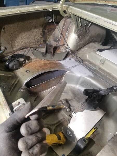

if you're happy with the fuel tank position as is why not lose the spare wheel well, fab a flat trunk floor and gain a ton of real estate for whatever mufflers you want?
neil.
That's a solid idea that I never considered. I think I was holding out maybe for a custom tank in there
( expensive)or storage of some kind. Crap. Today for absolutely no reason other than the challenge, I chose to modify the fab work and include a matching radius in the top piece using only things I had on hand.
Decided to stick with turning the spare tire well into a square tire well. Fuel tank mounts reworked and done. Plenty of room now underneath to run pipe to the through valance exhaust locations

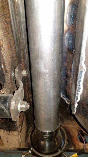

A couple hours here a couple hours there, got drivers side complete. The wall thickness on this aluminized econo Jegs kit seemed thin, actually was getting burn through. Got impatient after that, even with welding on the bench, low back hurts shoulders are trashed , Im 60, so Im really o.k. with these horse **** welds. Drinker side next
My first complete exhaust system ever so the juice is the discovery even though I could afford a custom shop. Upon mock up I discovered that clamps, with enough force to actually clamp, are a one time shot/ they dimple the pipe making it almost impossible to disassemble. Spent 2 hours jacking a muffler off a pipe with an air chisel

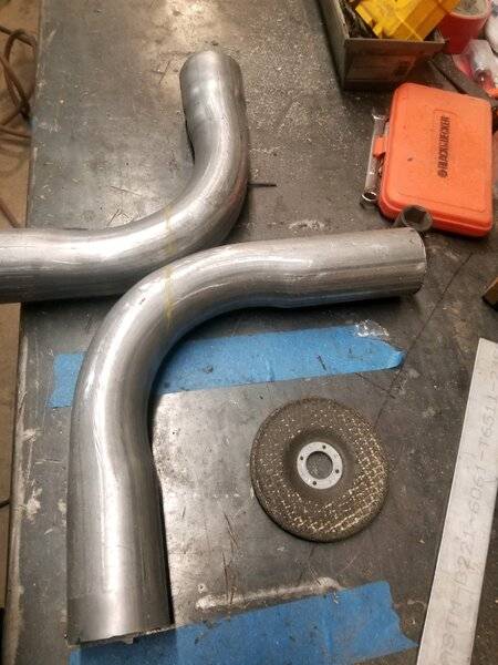

My hope was to get both mufflers to oppose each other equally in all respects but with the drive shaft 2.5" off-center to the passenger side gonna be another compromise. I need about a 3" jog for the passenger side muffler. Muffler shop explained why his bends would require 10" of radius distance, thought his squished 90's could work, no go there. Bought a mandrel Bent U from Summit for like $20( notice no squish deformation in the radius), cleared and leveled the bed on my tired old chop saw, added a temporary fence at the 2.75" I needed per piece for total jog distance with a psuedo bed for the leg and made 2 identical cuts, should work fine. Tomorrow Im hoping to install the finished driver side exhaust and move on with the passenger side.

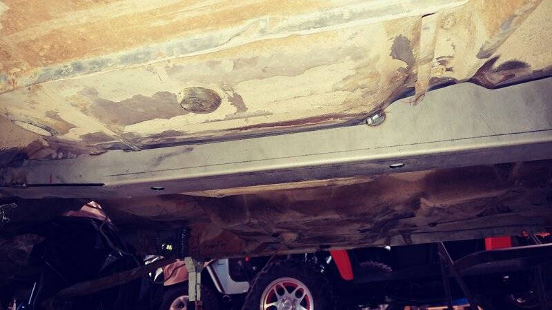

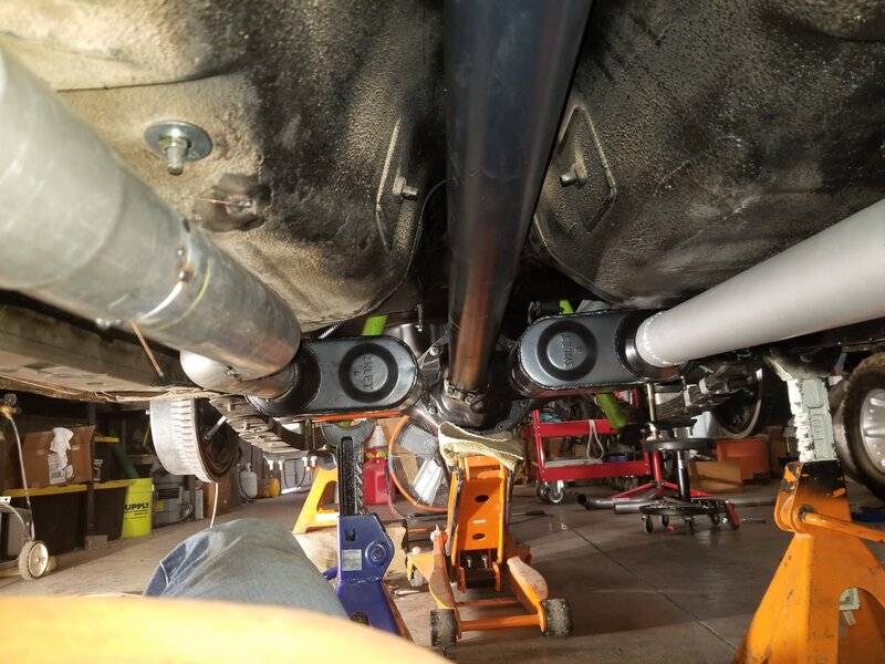

Saturday got the tin foil out for masking and started some under body paint. I should change the name of the license plate to CNFUSED since I've changed directions a few times. Hard to believe this shell was on my rotisserie years ago when media blasting and paint was the focus before so many mods. Shame, I could've at least painted the underside properly had I known the turns this project would take. For now, I'll have a proper half assed undercoat. Also Saturday I installed the completed driver side exhaust then got a jump on the passenger side fab work. I wanted to at least clock the mufflers the same and get them mounted relatively the same, you can see where the " jog" I made facilitated the Jegs kit direction on the passenger side. I used the rear reinforced seat belt mounting flanges for weld in mounting bolts/ weld on hangers. I'm hoping one hanger per side is enough. Exhaust tips are actually captured as well via 3 centering bolts so that might help. Creeper work lights up the neck so giving it a rest today.
Had an hour to kill so, got the last passenger side connections cut, fitted and tacked. All that's left is to drop it, weld it up and paint. Then I guess I'm on to the '71 Cuda fender Gills.
Got the exhaust 100% completed today. The last 24" of pipe I clamped because I'm not sure if the system would be too long to remove or not. Glad it's done and happy to be off the creeper, ready to get back on the road and hear the new sound.
