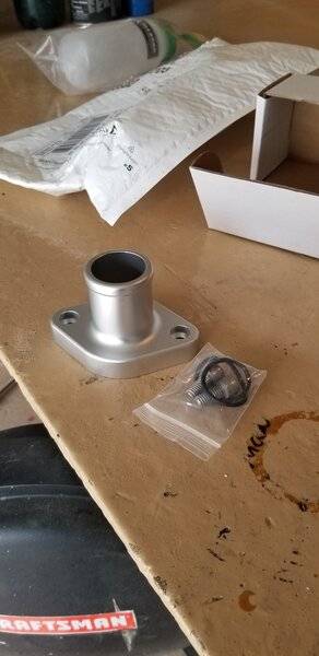

Yesterday I buttoned the steering and torsion bar up, got the car on the ground and cleaned up. Some friends I Mountain bike with came to the shop for a listen then we took a trail ride. Ive had bad luck in the past with o ring type water necks, this one from JEGS is currently leak free. Im thinking about installing pedals, brakes and a clutch now for a drive.

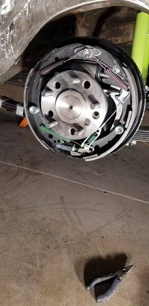

Getting started on rear brakes. Factory skinny brakes are what came in the car. Diff has been shortened along with BBP Yukon axles. The guy at Az. Diff swears 2.5" will work with Yukon flange back spacing. Got these backing plates from his scrap pile and one side installed last night. These are 11x2.5 so ordered 1 drum for a test fit. Should have today. Fingers crossed.
Ok guys, weigh in. 11 x 2.5 brake shoes are in place ( dummied with wire) shoe ends are secure in cylinder piston slots. 11" drum ( I used 1970 Satellite for ordering) seems to fit fine, spins freely with 0 interference. Check out pics, does the drum/ backing plate interface look right to you?
Lug holes are larger than my 1/2" lugs. Did these B body drums come with differing lug diameters?

Last weekend my youngest son and I finished media blasting and painting used parts. Found e brake levers and spreaders via Mancini, needed one brake shoe guide plate, Advanced Auto had exactly one which was shocking. Got cylinders, shoes, and hardware kits today, should be installing guts this weekend

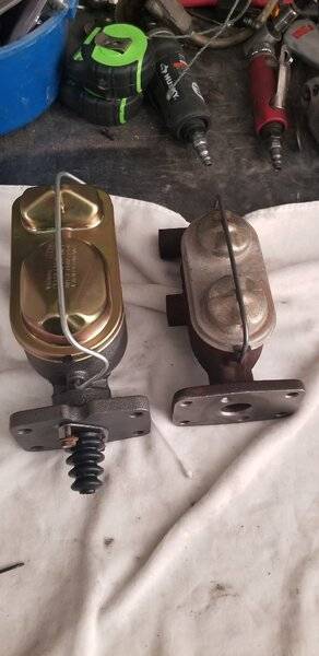

Rear brakes are complete, no hiccups other than a Left adjuster was packaged in my Right adjuster kit. I went with a new master cylinder from Classic, reservoir for front ( disc) is larger and has a natural gray anodize. No provision for the factory dust boot so I drilled and tapped for that. New front ss brake lines are in from Classic. Im waiting on rear ss brake lines, p valve, t block, feeder hose and distribution block, also from Classic. Refurbished Pedal assembly installed last week. Continuing fit up. If I choose to actually drive this thing before tear down and paint all I need is a fuel cell, finish brakes and a clutch.

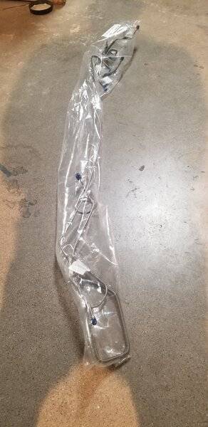

Axle housing was shortened a couple years ago, coupled with my 57 year old memory banks produced a nice surprise when mocking up the SS brake lines. What's Hot Rodding without mods right? It's comforting having the cam broken in and knowing I can start the motor for an open header party whenever I feel like an adrenaline jag. Hotchkis front sway bar is in after shortening the end links, just need to weld in brackets. Front to rear brake lines are back ordered and am trying to talk myself into a rear sway bar.
Works been crazy so Cuda time has been spotty. K member has been cleaned and sway bar repositioned for tack welding. With the rear axle shortened, modifying brake lines became necessary. I straightened one bend out in the left rear ss brake tube, the same bend got placed closer to the middle of the car so the tube clears the u bolts. I'm bribing my sheet metal guy with $500 up front towards the custom nose to get on his schedule.
