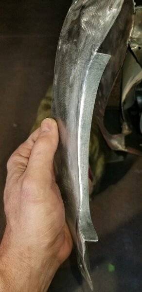

Working on fender features that will continue the lower nose horizon. First I needed a 90 degree return tab where this piece meets the grill. What's great about this to me is I did this in less than 90 minutes total time. Cut out the return, shaped, welded, ground using my "spot welding" technique with no repair or extra fill welds.
