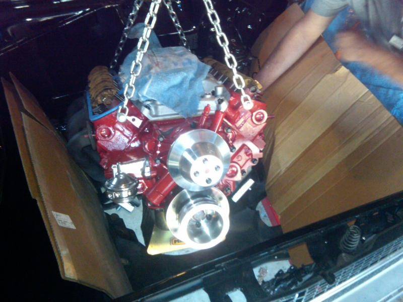

Me and Toby built and installed the 360 this wkend... it was a PITA though. For what ever reason we couldn't get the passenger side motor mount to sit flush on the biscuit pad...

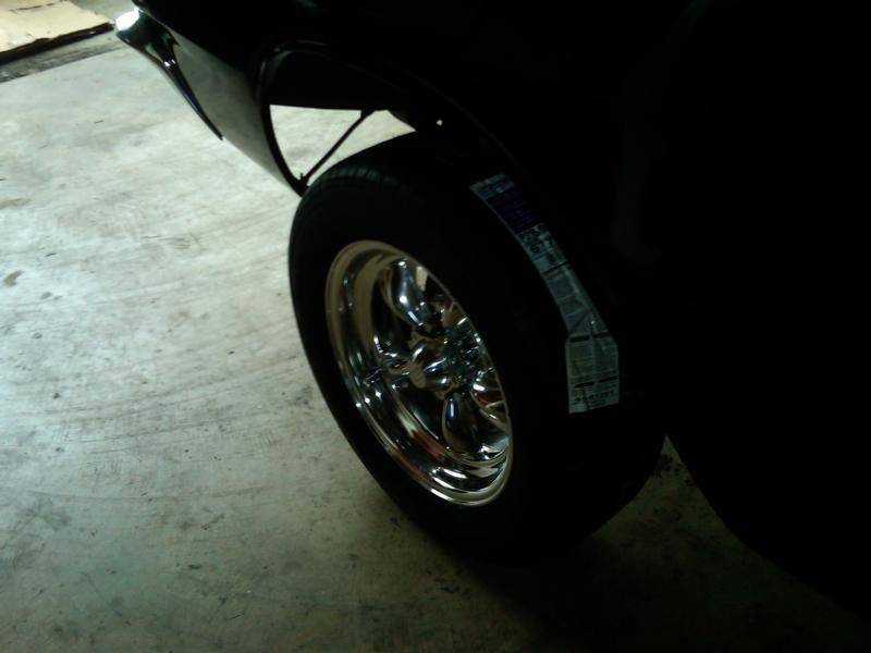

I mounted the front tires today to see how it sits... the front are 215/60/15's I dont like the way the front tires look. I should have bought 215/65/15's ... The brakes look really nice with these American Racing wheels though..

I can't see what you wouldn't like about them in those pics, but that is up to you. Looks pretty good to me!
it just doesnt fill the wheel well out like I wanted.... not a huge deal at this point.
Also hard to tell with the car in the dark.Im sure you have a much better vantage point.
Are your front wheels 15" x 6" ? I've gor a '68 Valiant with the same wheels (except painted) and same exact tires (215/60R15 BFG Radial T/A). My right front rubs on the front lower corner of the fender on sharp turns, and I don't have a motor in the car yet. Just wondering if you've got the same issue or not. I did the '73 up disc brake swap with the '73 up upper control arms. I'm wondering if I switch to the tubular arms if that may help gain some clearance (different caster angle I believe). I really don't want to switch to a 205/65R15, but you can see where mine rub in the pic below. I think the 215/60R15 fill the wheel well nicely though. Your brakes look way better than my stock pieces. Looking great... keep up the awesome work!

My wheels dont rub at all on my front fender. I'm not sure if its b/c of the control are or not....

I would bet with a good alignment that tire rub issue will go away. The problem, well not really a problem but the 67 to 72 front ends are 57.5 inch's wide and the 73 -up front ends are 59.1 inches wide so tire selection is key. I think the aftermarket front ends are even wider which is why most people that use them have to get rims with deep back spacing to get the tire back under the fender.
Im assuming the front end is rebuilt and fender is aligned properly and not tweaked.Itseems like a real small tire to be contacting.Or do I need glasses:glasses4:
It may not rub when the engine weight is in the car?
MY front is fine.. but to answer your question the tire is a little small IMO.
Can you drop the front end down some by backing out the torsion bar adjustment bolts?
It will change the way the tires fill the wheel wells and might make it more acceptable to you.
