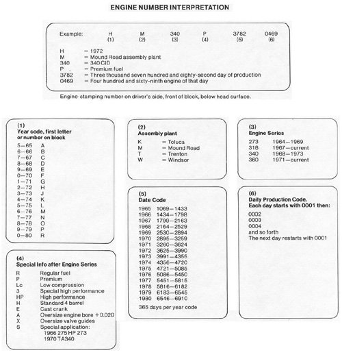

Supposedly the last 8 of the VIN # are supposed to match the 8 digit number stamped on the block below the head on the drivers side. The last 8 on the VIN # are 28144362
That # is even suspect. Based on the chart, the motor that was in the truck at inception was built in 1969. My title says the truck is a 1968. Who knows?

The stamped # on this engine is on the front of the engine, drivers side, right below the head.
All Mopar engines
All Mopar engines have a stamping on the front of the block below the drivers side head. It was stamped at the engine assembly plant and has nothing to do with the VIN. VIN's will be stamped on the motor/trans flange in 68, and on the machined pad above the passenger side of the oil pan rail starting in 69.

I found a chart if you will, online that has the breakdown for the number below the head on the front of the block, drivers side. Going by that number breakdown of PM 318R 25020444, this engine was manufactured or installed in 79, it was built in the Mount Road plant, it's a 318 that uses regular fuel. The engine block was built in 1968 and I don't care enough to figure out which day.
This means to me, at some point in 1979 they altered this truck, probably using extra leftover parts from who knows where.
I keep going back to the numbers stamped on the block below the head. It's possible that someone swapped engines and installed a 318 from 1979 and then found they needed to use the engines existing components that were on or in the truck at that time.

I went back and looked at the number stamped on the block below the head on the drivers side, P M 318R 2502 0444. Other than the P at the beginning, which could be a mistake, that number means that this engine is the 444th engine built (finished) on or around 8th of December. So it's possible that it could be considered a late 68 and therefore the 69 only timing cover may make sense.

The 2536030 318-6 is cast into the block on the passenger side below the exhaust manifold. The PM 318R 2502 0444 is stamped into the block on the front, drivers side below the head.
Is there another pertinent number?
