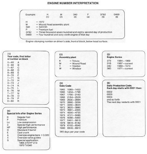

Alrighty then, I checked all the engine numbers and the casting number, 2536030 318-6 means it is an LA 318 built between 67 and 75. The 8 digit number stamped on the block below the drivers side head is PM 318R 25020444 which does not match the vehicle identification number on the tag inside and behind the drivers door. Unless this tag was changed at the time of an alteration, this may mean that the original engine was a LA 318?

I found a chart if you will, online that has the breakdown for the number below the head on the front of the block, drivers side. Going by that number breakdown of PM 318R 25020444, this engine was manufactured or installed in 79, it was built in the Mount Road plant, it's a 318 that uses regular fuel. The engine block was built in 1968 and I don't care enough to figure out which day.
This means to me, at some point in 1979 they altered this truck, probably using extra leftover parts from who knows where.

I can't believe that to be true
Do the last 4 match your serial #
