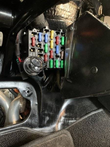

Has anyone used this kit with an a body that has A/C? I can’t see the fuse box fitting with the evaporator box right next to it. It definitely won’t go in with the a/c still on the firewall

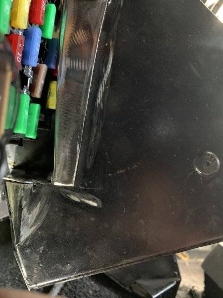

For anyone interested American Autowire’s classic update kit is not made for stock A/C in 1969 Darts. The A/C box needs quite a bit of material removed to fit the fuse block in and I believe the evaporator will get in the way of what needs to be removed
With some modification to the evap box it looks like it can just squeeze. Checking the dash light and fuel fuse will require pulling the a/c and heater box
