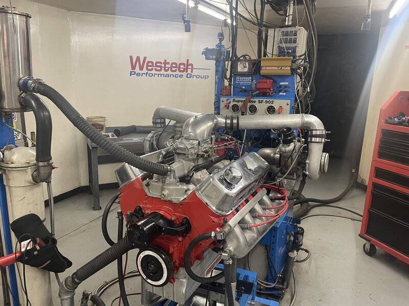

Any dyno session without parts on the floor is a success. As long as you learn something. Leaks on the hot side are killer and rob power fast, you might want to find some soft copper gaskets, they work well. I spent ALL day on the dyno yesterday with my big block. Lots and lots of carb tuning to get it right, and we made like 26 pulls on the poor thing. Beating on it hard. It did not care at all just kept chugging along. It came off the dyno with 70 psi of oil pressure and zero blowby so it was a win. One small water leak on the passenger side water log that needs to be welded up but that’s all. It was a good day.
70psi at idle!? My motor is 50 when cold but like 37 when hot at idle. Always has been. And after a ton of pulls I get a few drips out of my PCV that is just routed to atmosphere. But its nothing crazy. That's awesome though! Glad yours went better than mine! haha This is for the boat right?
I'll try the GM MLS ones first. If they leak, I'll find a copper set.
No not at idle. It’s 40ish at hot idle. 70 psi through a run. It touches 80psi at the top of the pull. Yes this is the pump gas twin turbo deal for my boat.
I wasn’t aware of the gm mls exhaust gaskets that’s good to know. What their OE application?
All of the trucks I've taken apart like early 2000s are MLS. I think all of the LS exhaust manifold gaskets are MLS, but I could be wrong there.
