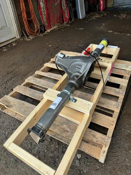

I also bit the bullet and ordered a strange 60 housing for the car. Everything else on the car has been replaced or upgraded so I figured she did great last year and deserves the upgrade. We've fooled with the original 60 3 different times, and we could never get the whining to go away. Every time we took the cover off and pulled the caps, the center section would fall out, even though we pressed it in. And its not the setup guy, I 100% trust his work and when I first get the axle back from him its quiet until I really start to push it. Using OEM Spicer gears and Timken bearings, so I'm not 100% sure what's going on with it, as I'm certainly not a gear setup master. However, I may sell it to someone with less HP with full disclosure of the symptoms. I'm around 800whp, so someone with a 500hp engine may never have a problem with it and its all narrowed to A body width and has all the stuff welded on it for the Reilly motorsports 4 link.
Here's the new one!

Here's the new axle all welded up and painted, ready for install!

Not hating, but curious of your decision to use a Dana rear end. I always want to ask this question, but usually its the purists doing it, so they would cry about using a Ford part in their Mopar. Clearly, you're not a purist. Dana's are known for being very heavy, then the obvious setup challenges. I feel like a 9" would be a better choice. Again, not hating, just curious. One last thing, do those upper arm mounts on the housing get any type of lateral support? Looks like they could deflect under load fairly easy.
I had the same concern coming from the offroad world with the tabs like that and being so tall, but Bill said he's never had an issue with them. I will say I have given the car its fair share of hardships and they've never been an issue! Now, if you were to put a camera on the rear frame and watched a launch, I'm sure you'd see some deflection, but not enough to bend or break the tabs above the welds. I thought about gusseting them this time, but I wanted to see if I ever had an issue. Of course now that you and I have talked about it, I'll rip one off at drag week lmao.
As far as the rear ends go, once you pull all the brake crap off and its just a housing WITH the diff in it, the Dana 60 was barely heavier than a 9in in the same configuration from what I found. I had done so much research on the weight differences when I started, but you know everything on the internet must be true! Id love to weigh them both myself. HOWEVER, the real reason I went 60 originally simply was because I had a housing already and I knew 60s since thats whats in the front of my buggy. I've never used a 9" before so it was all new territory and I'd have had to track one down or buy new. So I bought all the 60 upgrade parts and stuff for that axle, cut it down, welded the ends on put it together with my buddy gearing it. Then when I started having the whining issue since I already had the 35 spline locker and chromo shafts, it made sense to get the strange housing instead of going 9" at that point. If I was starting from a blank slate and had neither, I'd probably try the 9" honestly.
Thanks for the no BS answer. Makes sense to me since you already had experience with them in your off-road hobby. Honestly, I'd go with an 8.8 if I were to build something else, but likely the 9" if it had big HP. Mostly because there's a plethora of used parts for them.
Agreed. I would 100% go 8.8 if it would take it since every single rusted explorer up here has them with disk brakes and 3.73 or 4.10 gears for like $100 to $200

I have my 8.8 and its been holding over 1000whp for over 7 years in mine. Came out of a junkyard 2001 ford explorer. I narrowed the long end to fit two short side axles, not fancy bracing or anything on mine either. I started with 31 splines and now it has 35 splines in it now and full spool.
Thats good to hear Rich! I have one of those laying around already. Good to know it can take the power! I'd probably do that then instead of a 9" lol. I was told the reason they're so strong from the guy who did my gearing is because the pinion has SO much support the way the center section is casted.

The Strange S-60 is supposed to be much lighter then the original Dana 60 due to different type of cast iron used on center section per Strange web site. Also older Dana 60s vary in weight due to differences in tube thicknesses. Some Dana 60s said to be much heavier then others.
Strange S-60 has threaded adjusters for diff bearing preload backlash adjustment. Old Dana 60 uses shims. Doctor Diff said I could not get a Power Lock diff cause that only fits Dana 60 not Strange S-60? He made it sound like differentials not interchangable?
Dana 60 supposed to be lowest parasitic drag rear diff due to gear design from what I read. 9 inch Ford is said to be very high parasitic drag.
My buddy ran 9s with full interior '87 Mustang C4 auto trans slicks 8.8 rear 35 spline axles. He never had any issues with that rear taking that abuse.

You can always add more bracing than i did. Obviously I have the tubes welded, and 9" ends with c-clip eliminators because if you're doing the work you may as well make sure its good to go. If you call yukon gear and want a set oft heir 31 splines, narrow it 2 7/8s on the long side they will sell you the kit with two short side axles like they did for me a few years ago.
What size tire? Gear ratio? Weight of your car? And how fast have you been on that rear end? Sorry about asking so may questions but I’m seriously considering using an 8.8 and I HAVE a 9” housing and a completely finished mopar 8-3/4
