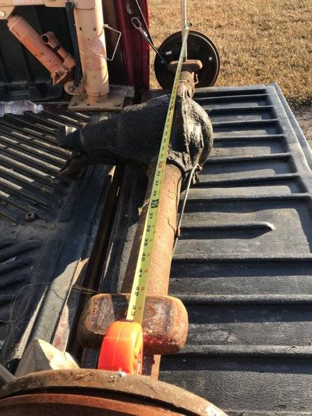

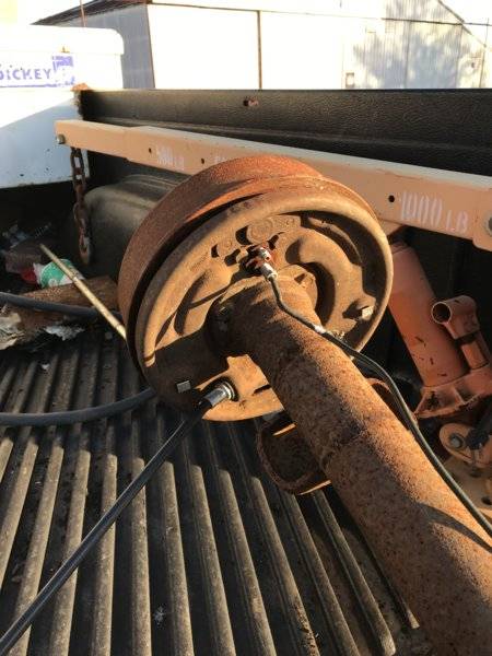

My Mopar rear axle dimension guide says yours should be about 57.5 drum to drum which is what I have. All 63-72 had that meas. on A body cars.

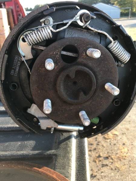

All 65 to 72 a body’s had factory 4 inch bolt circle, even the 8-3/4 axle. It’s probable that someone had swapped a late model rear into the duster you had gotten the rear axle from, though. I had to do that on my first ‘71, I got the donor from a ‘74 valiant four door with disc brakes on the front. It was a six cylinder car and had wider drums on the back, but I don’t remember the diameter. But it was still a nine bolt cover. The outside stud width and spring pad widths were identical.

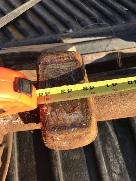

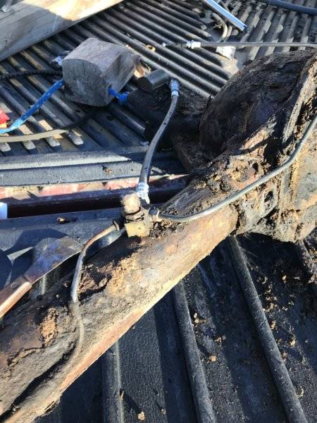

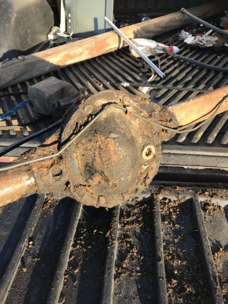

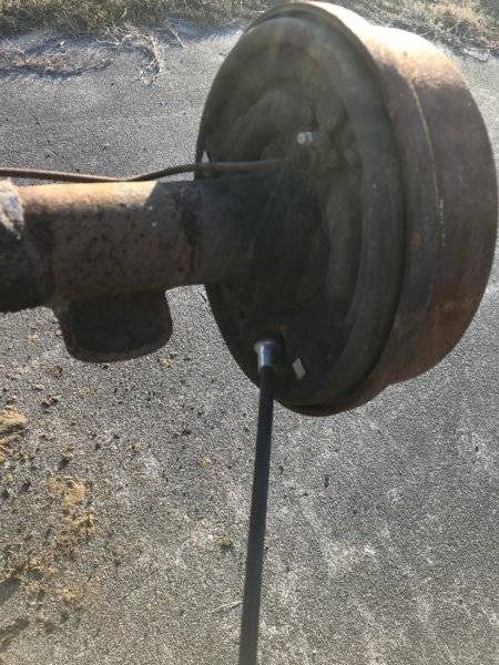

Thank you sir. If you get to it measure the drum to drum for total width. The 43" ctr to ctr for the springs is correct to my needs.. I'm sure thinking about it. You'll have TO HAVE AN OLD WIRE BRUSH TO SEE THE CASTING #. Should be on the lower right center casting not on the axle housing. Thanks again.[/QUOTE
Had to go out to the business so I went by the hangar again and looked at the rear end again. Scraped and brushed some more. No luck on a number. No number on the axles either. It is measuring 51” from drum plate to drum plate.
Joel, If this is a non sure (open) grip rear. The parts you need are spider (pinion) gear part number 2404 195
Also recommend axle end gears part number 2404 194
