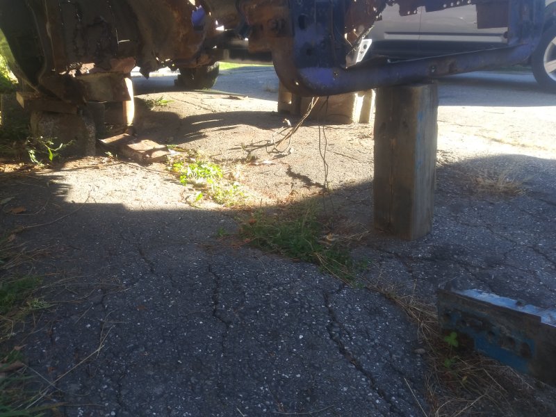

Yesterday was the first frost at my house in upstate New York. That's a sign that the outdoor Demon work may be winding down for the year until about March, when things start warming up again. It's no fun to turn a wrench when you can't feel your fingers. To speed up progress before snow comes, I took off this weekend to work on the car all day Saturday and Sunday. Typically me and the wife take weekends off to disappear into the Catskill Mountains and bike, hike, boat, camp, etc.., but I want to get the meat and potatoes (firewall patch and rolling frame install) of this car done before the end of the year. All the rest of the work is cake.
I was thinking to move the Demon into the heated fully equipped garage for the winter, but then realized I don't have one.:lol:

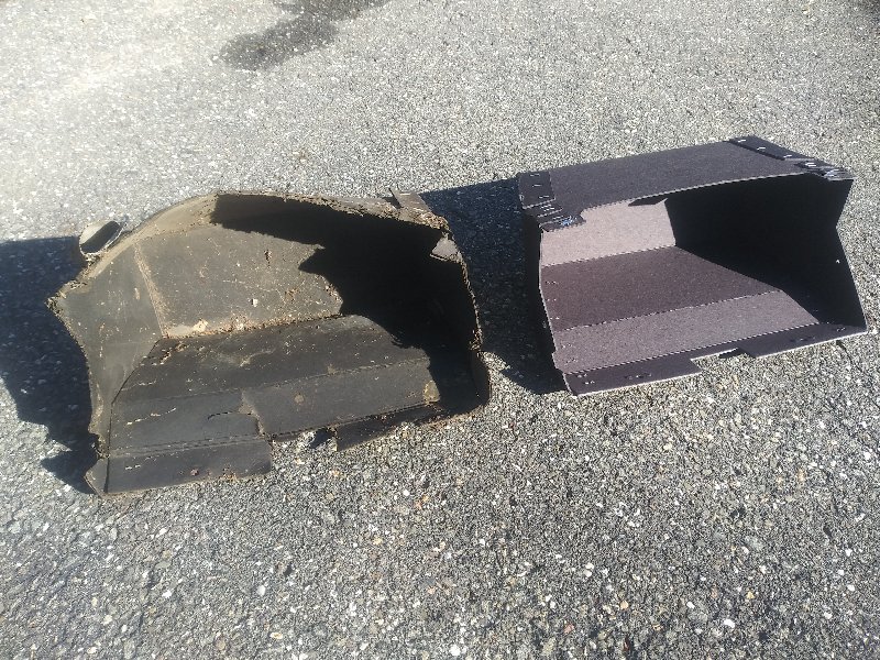

The new repro glove box was delivered yesterday. It seems very slightly thinner gauge than the original, but still matches up pretty good.

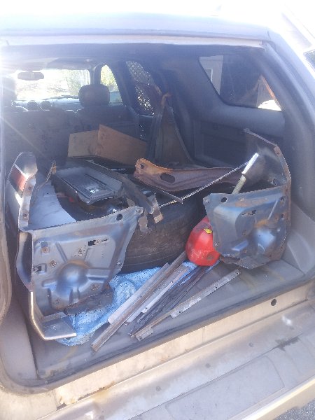

The nose got delivered this morning (both front fenders, fender extensions, grille, front bumper w/ mounts, lower valance panel, hood latch shelf).
I just bought one yesterday. What company did you get yours from?
I bought it from TNT Auto Parts in Michigan. There were a few other options, but this was the least expensive. I originally wasn't going to replace the glove compartment, but figured since the heater enclosure was removed from the firewall, it's better to replace the glove compartment now because I don't think you can install it from the front...

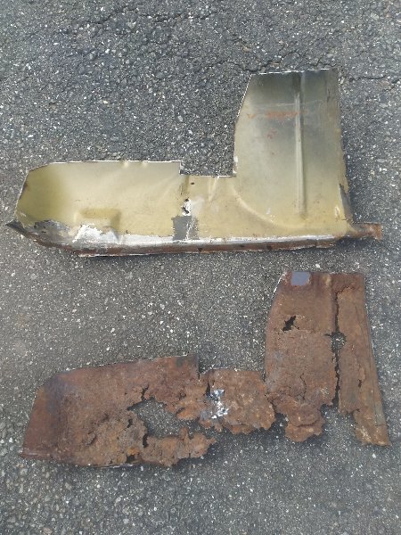

Now working on cutting out the rusted areas of the firewall and replacing them. This is one of the two patches that were cut out to be replaced. I'm going to butt weld them, so no ugly overlapping. Butt welding is alot harder than overlapping, it takes alot of cut/fit, cut/fit, cut/fit... This is more difficult and time consuming than replacing the whole rocker panel was..
The two firewall patches are roughed in, now have to finish welding the butts and clean up the welds..

Actually it's super easy. The hardest part is finding time to do it. Now that the days are getting shorter in the northeast and daylight savings time is coming next weekend, that will pretty much destroy any chances of working outside on the car after my office job; because I get out of work at 4:30 pm and it will be dark at 5pm. So the project will soon have to be wrapped up and wait until March to finish it. :(
Then after the firewall is done, the frame will be prepped and test fit a few times to be sure that everything is lining up correctly (frame to firewall to engine enclosure to frame rail connections to kframe alignment) before welding. So far everything has been surprisingly plum. But I did notice that due to slack factory tolerances, there is slight leeway when installing body parts, which is nice for a newby like me.
