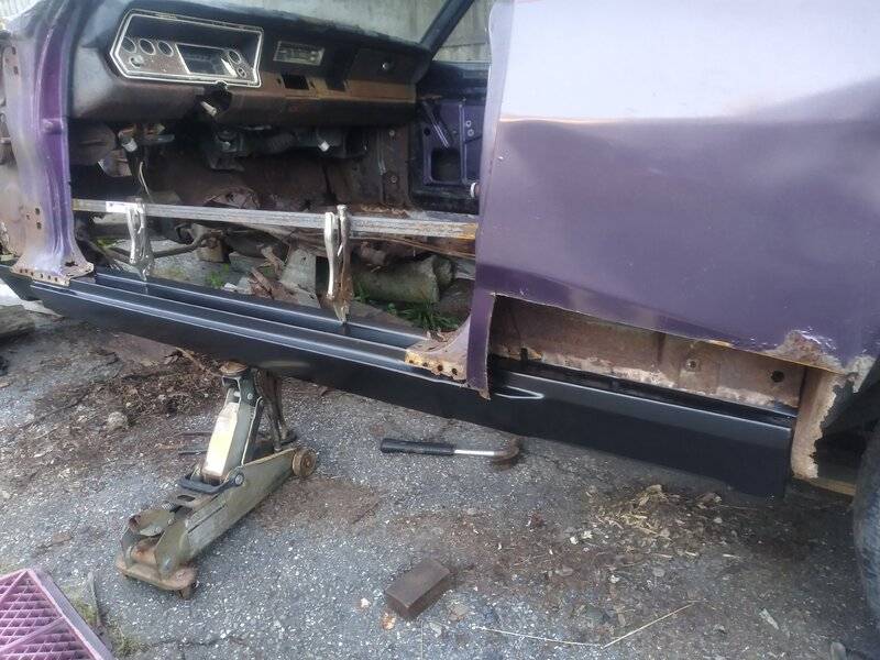

Yesterday I finally received the outer rocker in the mail, so I finished up removing the rusted rocker today. I didn't want to take the old rocker out until I received the new one, so the car didn't have to sit unsupported for too long before the new rocker went in. Now I have to start prepping and also adding some patches here and there before putting in the new rocker.
Just for fun, I'm keeping a rough tally on the body work hours. So far I'm up to about 22 hours (removing what was left of the floor and full length rocker, and drilling out about 150 spot welds). (The rocker took 7 hours to remove, after all the rocker spot welds were drilled out.)

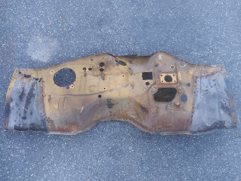

This past weekend I picked up the firewall in upstate NY. As someone in this forum stated, instead of replacing the whole firewall, I'm going to cut out the rusted areas and overlap the new pieces. Then prep the bottom edge where it will be connected to the new floor.
Today I spot welded the rocker together and did some more test fitting to the car (3 hours). The AMD parts so far were pretty good, not the best. But working with new imperfect parts sure beats working with mangled used parts.

Today I finished installing the rocker (3 hours). I just need to finish prep the welds for smoothing out/paint.

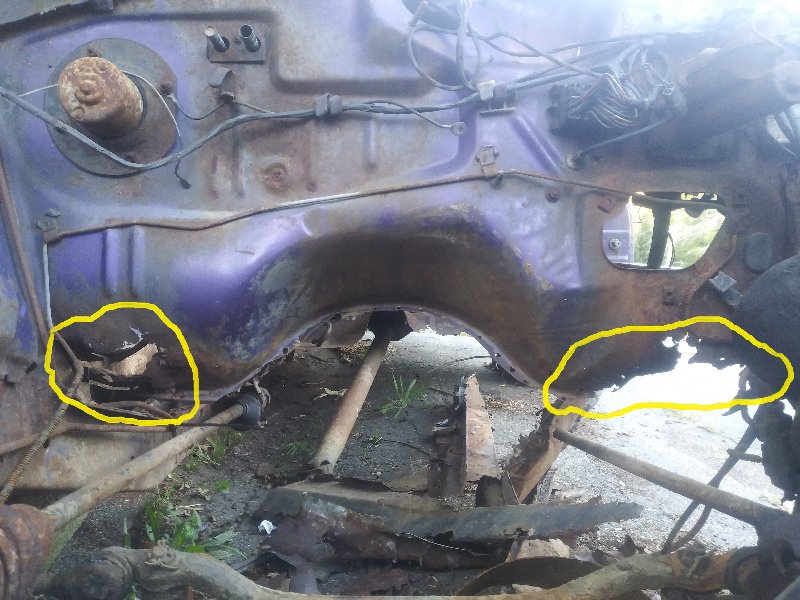

Tomorrow I'm going to start removing the frame and K-member to prep for the installation of the new frame. I formulated a plan, penned the cut marks with the paint marker, and will start chopping tomorrow..
Today I finished disconnecting the front fender brace things, what was left of the trans crossmember, and drilled out all the spot welds of the engine "enclosure". I also cut the frame ahead of the k-frame, like I said in a previous post. I then dropped the whole frame, k-frame, and suspension out of the bottom of the car (9 hours).
Tomorrow I'm going to start cutting out the bad areas of the firewall and patching it up. Then patching/prepping the enclosure and the new frame for installation.
