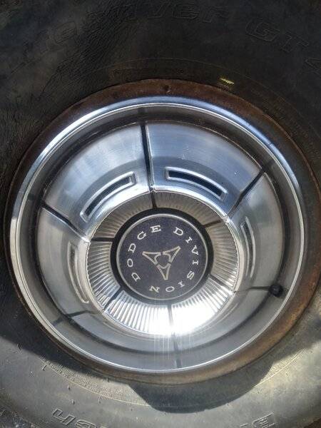

I also picked up some super cool patina dented and dinged correct W11 deluxe "wheel covers" for the Demon at the Carlisle Chrysler show. The car did not have a data plate when I bought it (it rusted out), but don't know if deluxe wheel covers would be shown on a data plate anyway. But by doing detective work, the wheels appear to be original, and they are black (not body color, which would show that the car was manufactured after mid-March 1971, after the transition from body colored wheels to black wheels OR if the wheels came from the factory with full wheel covers, which would have been supplied with black wheels) and had deluxe wheel covers (not poverty caps), based on the scrape patterns on the rim of the wheel.
Disclaimer: Alot of people may be wondering why so much time is placed on crappy hubcaps that most people junked, and not why kick up the horsepower, replace the wheels, and beef up the stereo; but I'm shooting for the car to be as correct as possible, from the '71 225 slant six engine, to the R11 Music Master AM radio, to the crappy hubcaps.
Update 11/28/25: The Detroit Horsepower website said that this car had a planned build date of 9/14/1970, so I'm pretty sure it came with the black wheels and then would have had the full wheel covers.
