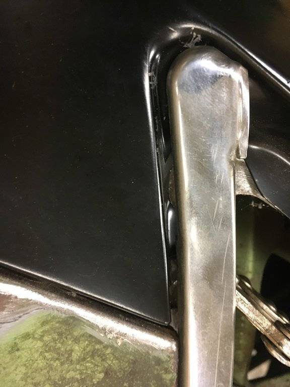

I had exactly the same problem with my quarter panels and after I gave up on moving them any further forward there was only two options left, alter the quarter panel or alter the edge of the trunk lid.
It would have been a many hours of work and messed up a lot of the inside that I had done and warped the top of the quarters so I chose to grind the edge of my trunk lid back to the gap I wanted and cooling the weld with air as I went welded up the edge and finish it with a mini grinder and sander, you can see by how little damage this did to the primer that it had no effect on the trunk lid skin as far as warping and it took an hour or two compared to many hours and filler and nobody would know it was a problem. Just remember that you have to remove enough knowing the weld itself will build it back out some.
Hope that helps you out Red383.
Your Swinger's looking great. Wish I was that far.
I do have another quarter panel install question if you don't mind. On the AMD quarter at the front corner of the deck lid, the gap gets really tight. I was wondering if I should make a slice in the top of the panel at the green line, and tap that metal over to open up the gap? then weld it back up. Any input would be appreciated.
Thanks
You may have to clamp the trunk lid skin down to the rest of the inner if it should separate slightly till you get a couple of tack welds but I don't believe I had that problem.
Great thanks. One more since I have your attention...
In the rear window channel corner, I placed my molding on to check fitment, and the new AMD quarter is coming up short. How would you close this gap? I was thinking about tacking a filler rod in there to close it up, like I saw someone do on their door edge. What's your opinion.
Thanks a bunch.

It might be possible to fill this area with steel but that's a really awkward area to grind and shape it nicely, you might fill the straight area by welding some steel rod on there since its easy to grind to what you want but I would fill the corner with ALL METAL and I just might fill the whole space with it. This is not an area that flexes or moves and ALL METAL has some flexibility and unlike polyester body filler its waterproof but if you caulk this area well before painting the water should never get to it anyway.

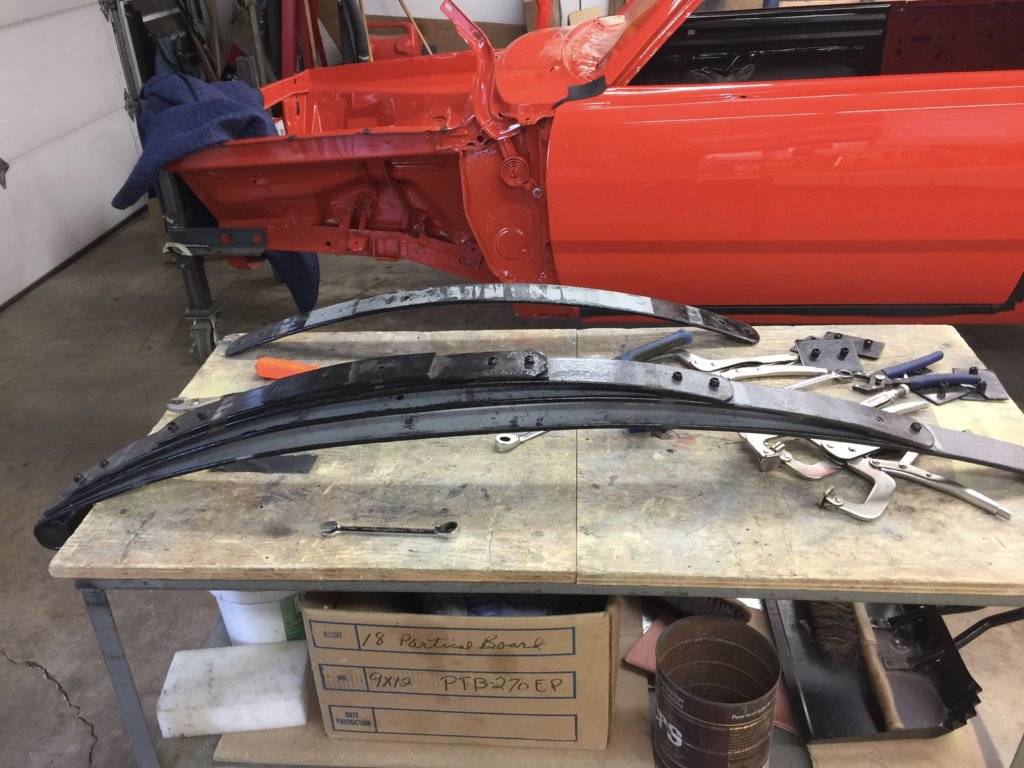

Also took my new leaf springs apart and sent them off to the powder coater to get a much better paint job then what was on them so hopefully I'll get those back this week,
Some small progress but better a little then none, the march goes on.
... Also took my new leaf springs apart and sent them off to the powder coater to get a much better paint job then what was on them so hopefully I'll get those back this week,
It's just my own two cents from years in the powder industry, but leaf springs are one of those "touchy" things you should only trust to a VERY experienced coater. Leaf springs have Delrin liners in between each leaf, a specialized (usually Teflon) item that does not hold up to the heat required to either outgas the metal or to cure the powder. Without them, you end up with too much room in between the leaves (which just gets bigger once the car is on the road) and ultimately creates a hazard both for the driver and others on the road. Imagine cruising down the highway at 70 and one of your leaf springs just decides to fall apart ... yikes.
New liners can be purchased but the aftermarket ones don't really have the best reputation. Do your own research before making a commitment. This is an older thread but not much has changed in the meantime. Leaf spring liner
Thats good information Leanna, I did remove all the plastic sliders and took just the bare springs to the powder coater. In discussion with him we decided to keep the film build down since the springs flex a lot and a thick film would likely crack.
Interestingly I bought these from Chrysler and they only had the plastic sliders and no Zinc interleaf's like my originals,
I did purchase a rebuild kit that has the plastic sliders and the Zinc interleaf's so I'm hoping that with the powder coating and the proper rebuild they will be better then the way they came and will standup and not get rusty for a long time.
Good deal! I'd just hate to see ya get hurt sweetie. Sounds like you have a great plan and the right stuff to pull it off with. Keep us posted!

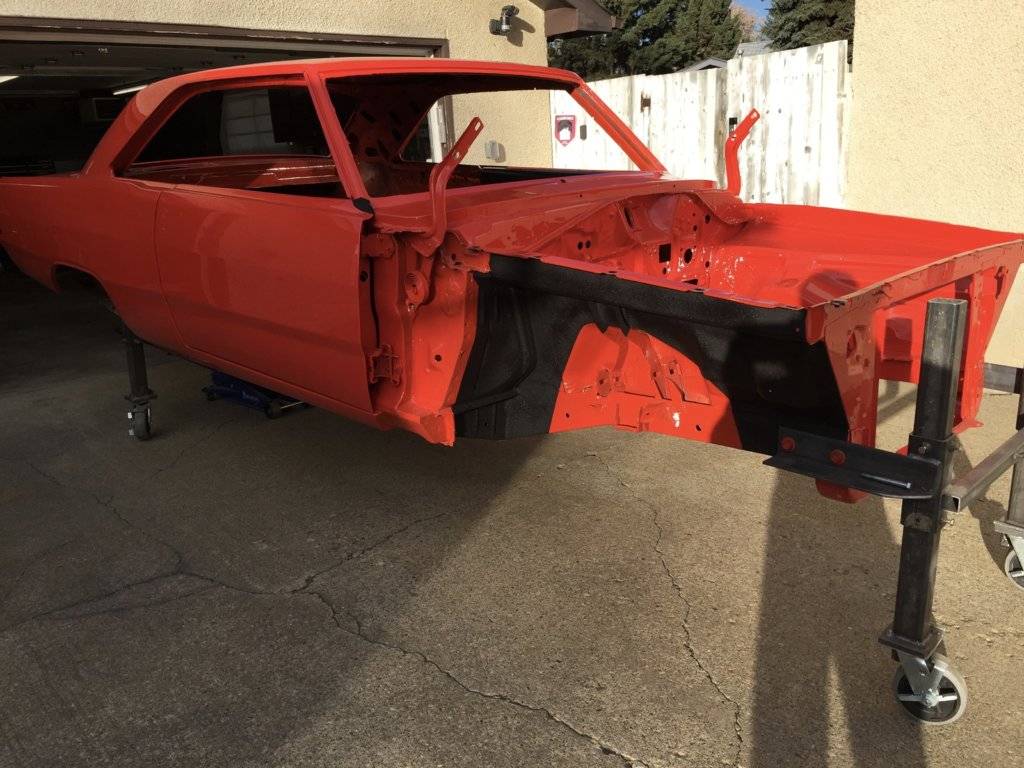

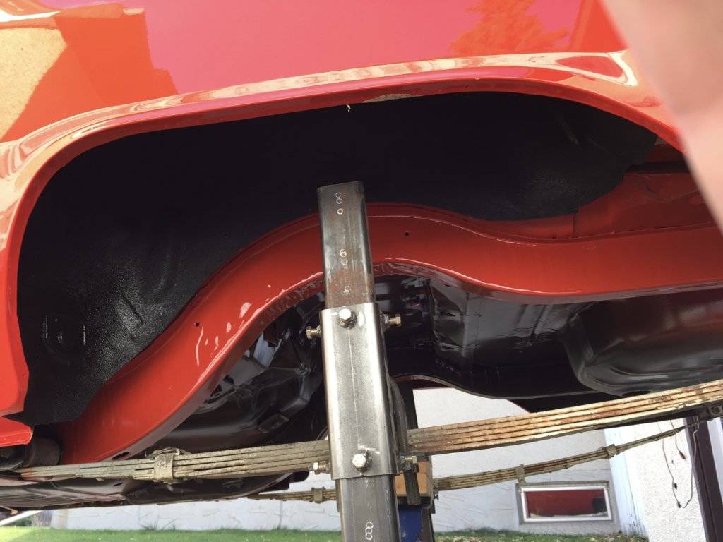

Needed to take advantage of the nice weather today since its supposed to go away probably until spring and get the undercoating on close to the way the factory guys put it on (not quite as sloppy) so got to work and masked it all up and gave it a scuff with red Scotchbrite. Then I got out the RestoRick's undercoating that matches the factory stuff really well and put a couple of coats on. It's been my experience that since undercoating and or rock guard left in a raw state attract road grime and dirt and it tends to imbed and permanently make the undercoating look dirty so it's best if the product you used is rubberized and paintable that you put a black paint or coating on top of it. In my case I have some black Epoxy that should work nicely and not be too shiny and will allow the undercoating to wash off much better then if it was raw,
S W E E T !

I noticed a lot of 70's cars had the underside painted white, I was wondering why that was the "in thing" to do back then? All the pics of my dads friends cars from the 70's including his was painted white underneath.
