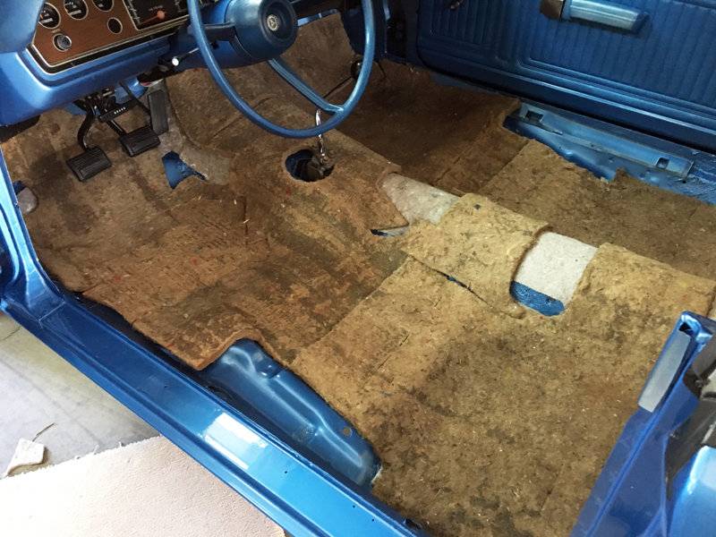

So, seeing your jute, and I see that's it's quite a bit different from the 'vinyl' floor version, here's what mine looked like, I repaired my original and placed some of the 'supplied' jute underneath (super wimpy compared to the real stuff). Also, I put a copy of my 'simulated broadcast sheet' in the springs as well. Too cool.

I still have my original jute that looks just like yours, it looks kind of dirty and a bit musty and Richard offered this newer stuff when he was out visiting so I took him up on it.

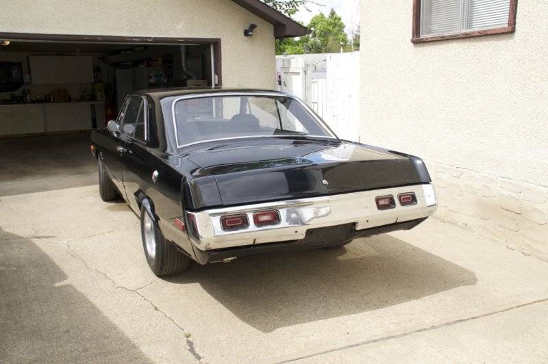

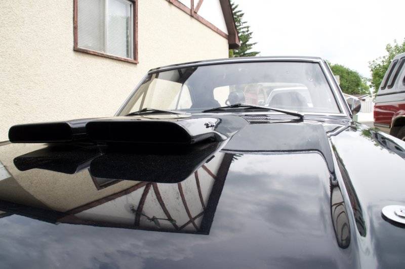

Sorry everyone i haven't been keeping the thread up since getting close to being done. The cars been done for 3 or 4 weeks now and have just been working out the gremlins, some time machine pictures from 3 1/2 years ago to now,
Took it to the big Mopar show for Alberta in Red Deer and met up with some of my 340 Special brothers, 6 which is the most ever to be together at once. It was a great day and lots of fun and laughs!
So the build is done and it was a ton of work and lots of fun and scraped knuckles but really rewarding, now I can show it to other car lovers and most of all enjoy driving her again. Thanks for all the members that asked questions and gave me kind comments and encouragement when it was tough dragging myself out to work on it, Cheers!
