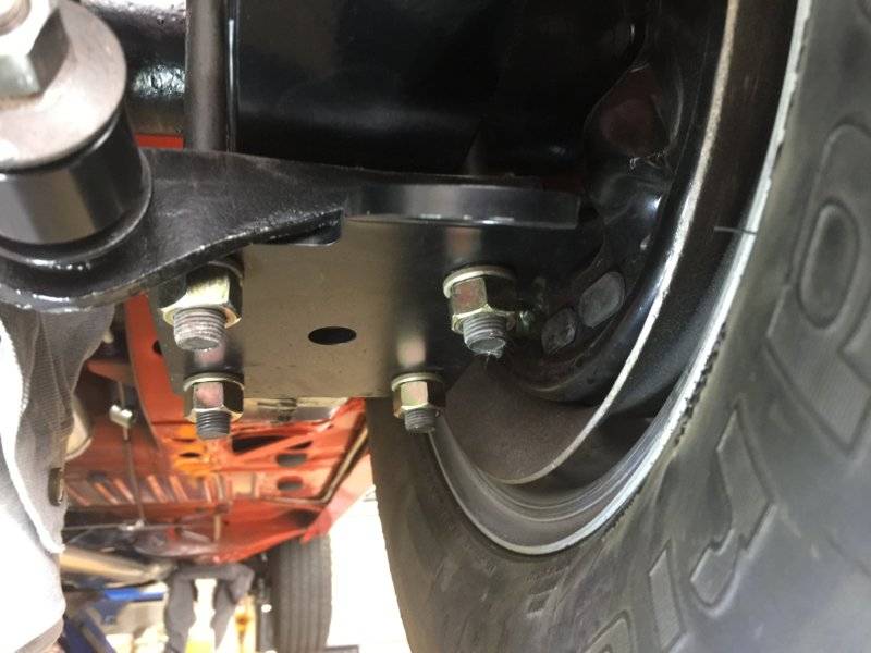

I saw these trailer tie down brackets on posting on FABO from another forum and thought those were perfect so I emailed Randy, the fella that makes them, and he sent them to me. They are very nicely made and fit like a glove on my 8 3/4 so I epoxied and painted them and installed them last evening. The only small issue I had was there wasn't as much thread left on the U-bolts using the washers as I would like to get a full bite so I left the washers off and used some thread locker instead and that worked fine.

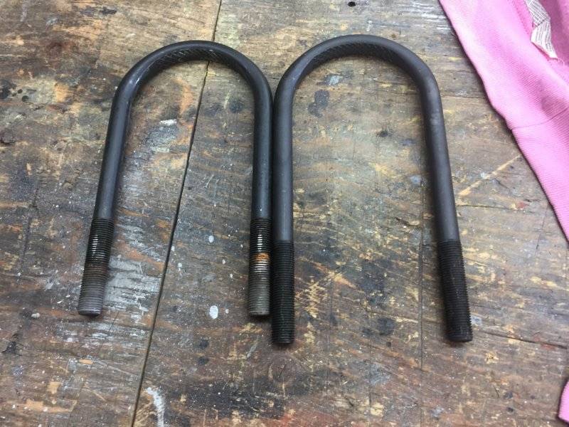

Swinger340Canuck, where did you get your gas tank from? I can only find the ones dimpled for the sideways strap. Nice brackets, however o would get longer U bolts. Should have minimum 3 threads showing to be on the safe side IMHO.

Yeh Dave they should work great, I copied for the front what my friend Kevin (Scatpacker) uses on his which are these brackets that bolt thru that unused hole on the K-member,
The difference is these prevent the cars suspension from working while in the trailer and the back ones allow the suspension to travel, so something that attaches to the lower control arm might be a better front solution.
I got my gas tank from Auto Metal Direct at the same time I ordered my body panels, and I'll take your advise on the longer U-bolts and order some up, thanks.

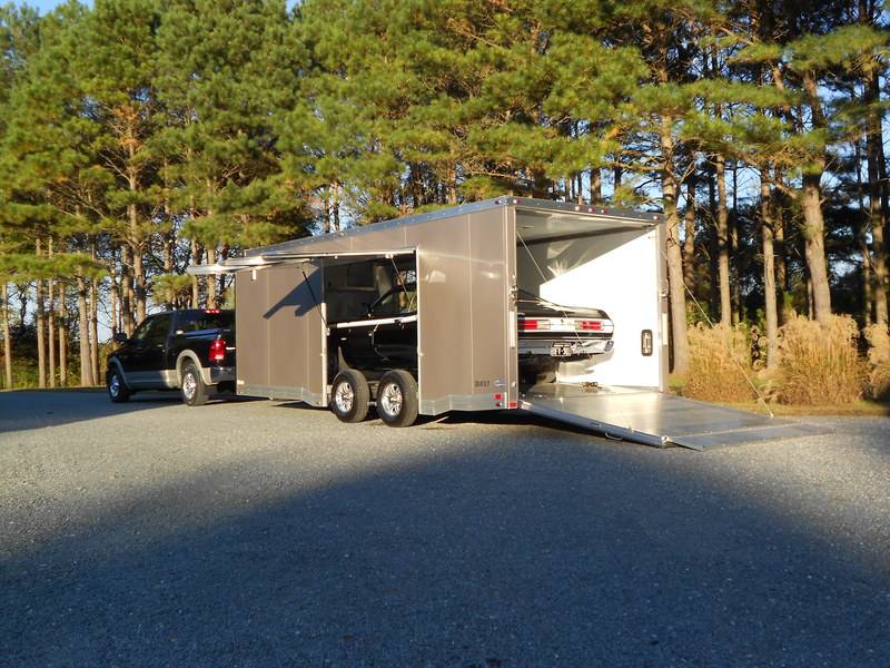

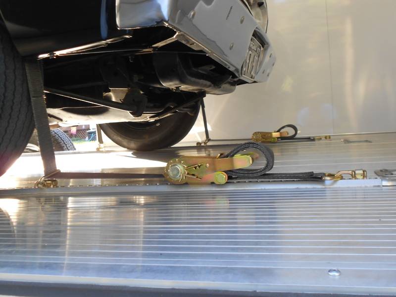

I am thinking about using those brackets for the 77 Doba. For the Duster I purchased a set of over the tire tie downs from MAC'S Custom Tie Downs. I don't have to lay on my back and they allow the suspension to do it's thing during the ride. Passenger side installation is little more of a squeeze as you can see but I'm still quite limber Ha!
That’s the perfect setup, both trailer and the tracks with overtire straps. Did your trailer come with the tracks or did you add them after?
I spec'd the airline track with a LOT of other upgrades when I had ATC build the trailer. An 88" escape door on the other side would have surely made things easier but it's not bad really. Besides, I was tapped out after adding options!
Followed moparmat2000’s advice and got some 7 1/2 inch long u-bolts to safely attach my tie down plates which worked out perfect, thanks for the tip.
