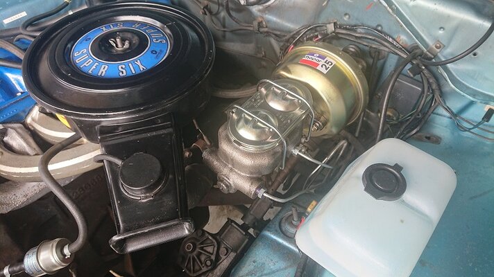

Hi Troy
I'm not stuck. I have had to adapt a generic booster/MC kit (found on ebay) and it works.
Doesn't look original, but it works.
François

I purchased this kit on Ebay, and it works well.
Booster on Ebay
Also exists in 8" and 9" diameter for high-performance cars.
The main problem with universal boosters is that they have only two mounting studs for the master cylinder (today's standard).
And old mopar master cylinders need four mounting studs.
So, it's easier to buy a complete kit including matching booster and MC.
Booster on Ebay

On that eBay link you sent, it states it is for Chevy. Or at least an upgrade from “GM” boosters. Is that still okay? Is it sort of universal?
Yes, sort of universal.
Designed for Chevy because it looks like a Corvette booster.
But like all universal parts, these boosters have to be adapted to the car, e.g. the mounting studs are in a square and measure 3 3/8" center to center. On our A-bodies, the holes of the mounting bracket have a rectangular scheme. So, you'll have to enlarge them to match the mounting studs squared scheme. Quick job with a good round file.

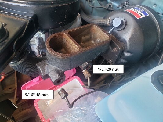

And another trap : the brake line ports
On our original Mopar A-bodies master cylinder, the brake lines fitting nuts are 9/16"-18 in front and 1/2"-20 in rear
The "Chevy" master cylinder has the brake lines fitting ports are inverted : 1/2"-20 in front and 9/16"-18 in rear.
You'll have to modify your line ports or use Edelmann master cylinder adapters #258306 and #258307 (cheap and easy)
And don't forget to buy the extension rod eyelet to connect the brake pedal link (it's not provided with the booster)
Extension rod eyelet
Other than that, it's plug n' play. :)
