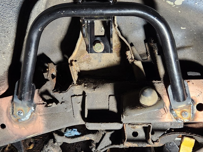

Lets assume I am going to weld the shock hoop on the chassis.
Here is what I see I need to do...
  • Remove the shock hoop from car
  • Pull the HDK 1/2 in sleeves
  • Clean welding surfaces with flap wheel
  • Weld/fill the 9/16 hole on the outside wall of chassis
  • Weld/fill the 3/8 hole on the inside wall of chassis
  • Spray Weld-Thru primer on chassis
  • Clamp the hoop in the correct location
  • Weld
  • Paint
The issue that caused this problem is I had to over drill the outside chassis holes to 9/16 to allow some wiggle room for the bolts to go thru the crush sleeves and chassis.
My question/concern, what about the exposed weld on the inside of the chassis. Isnt that going to rust? How to I protect against that if I dont have access to it?

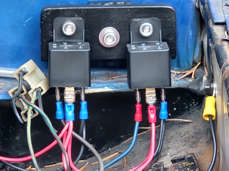

Ok, I am not sure I showed my solution for the ignition power. Based on the suggestions here, I went with two 4 terminal relay approach. Then used the blue and the brown wire from the wires that goto the resistor. Blue has 12v during run, Brown has 12v during start. The blue and brown wires are only used for triggers and pass thru the relay to ground. The relays get a 12v which will come from a breaker protected power distribution block (such as the one from MSD) straight from battery. There is the possibility of replaying the relays completely with the msd power distribution block. More on that later.
So in further investigations after finding the below charging circuit diagram, both the blue and the brown wire come directly from the ignition switch. In the event of the blue wire, it also goes to a field post on the alt as well as a post on the voltage regulator. As the 12v source is coming from the ignition switch, I am going to assume that its safe to use in the method I am, unless someone here believes I am making a mistake.

get some cavity wax and the long nozzle, you can coat the inside of all the inaccessible areas then.
neil.
Ok, I am looking at Cavity Wax. KBS seems to be highly liked, as well as 3M. It appears that the 3M has a better wand for a more complete coat. Do you have any brand recommendations?

Well, with a short conversation with Denny from HDK and the unplanned death of my mini-lathe, welding the shock hoops on is the plan. Thanks to MyGasser for the suggestion of Cavity Wax. Will keep everyone updated as it comes.
Regarding the welding and repairing of the drilled holes, I am considering welding the 1/2 and 9/16 holes closed. Then grinding them flat. My other thought is use my hole cutter to cut little doughnut pieces of metal which will fit the hole, then weld around. And again still grind flat. Thoughts?
Keep in mind, I am a unemployed Server System Engineer, not metal fab. I do have a good mig welder with gas that runs on 220v at 40amp, and it makes me look pretty good. But I am only guessing on what power and wire feed settings I should use based on research from the internet and the supplied owners manual.
I am considering putting 2 tack welds on each arm of the hoop, then pay a professional mobile welder to complete the job. Even still, I have holes in the chassis I need to deal with. Seeking suggestions.
re welding holes in sheetmetal, grab a thick flat piece of copper and hold it on the backside of the holes while welding them. the weld won't stick to the copper and you get a fletter backside to the weld so less grinding.
neil.
neil.
Thanks for the advice, sadly I got this advice after I completed the work.
So the car now has the shock hoops welded in. I started my weld on the face of the metal and rolled it into the back so that I had enough thickness grind. If any holes showed on the first grind, weld again and fill any additional holes result to welding. Grind again, and good to go. Took a portion of the chassis to metal, sprayed with weld thru primer, located the shock hoops and welded. I will be painting front end parts and installing the remaining kit over this weekend. Painting is going slowly due to colder weather resulting in a colder garage. That color you see around the weld is the copper weld thru primer. I will be painting primer and paint tomorrow. Should be ok for tonight.

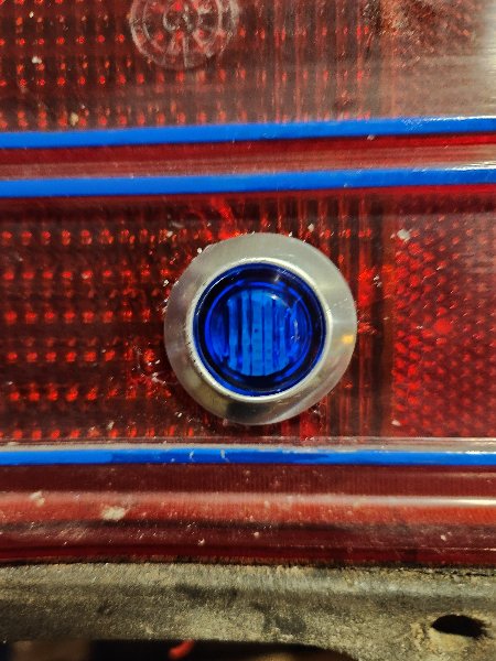

New blue dot solution in place. The blue LED's I bought which I was going to glue behind the glass blue dots, they have replaced the glass blue dots. I used the blue dot metal holder to install the LED in, then installed like normal. Only now, I can tie the LED to just the brake circuit if I wish. Or maybe a switch to just stay on. Dont know for sure.
