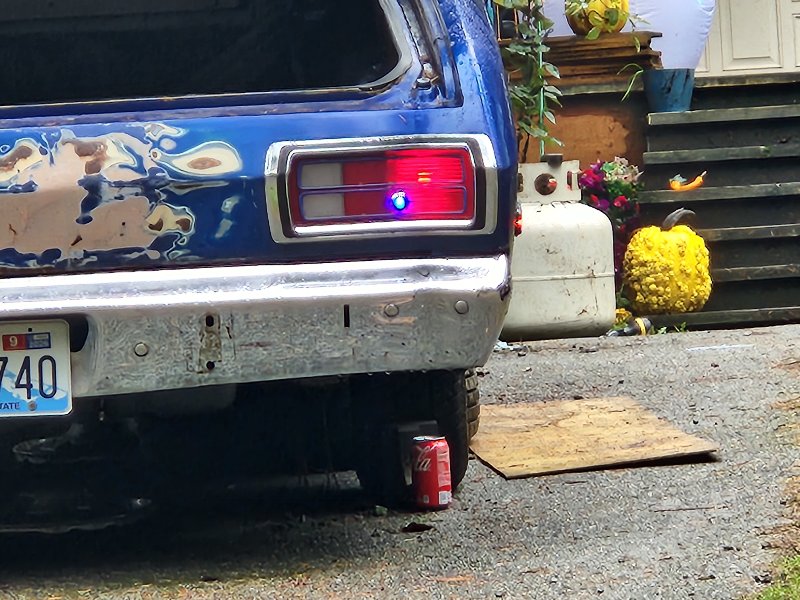

Meanwhile, check out this modern solution for Blue Dots. Will get pictures in the evening a bit later. I am just testing now.
Right now the LED is on a dedicated circuit. I will probably give myself some options to tie to the tail light or brake light when its done.

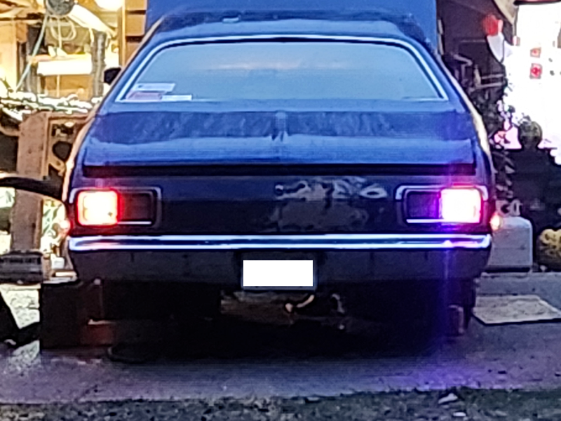

If you look closely, you will see the blue rings around the tail light lenses. I kind of like how it turned out.
OMG, if only you could see the grin on my face. The effect looks great. The LED on the passenger side is lit so I can show a comparison between driver and passenger.
