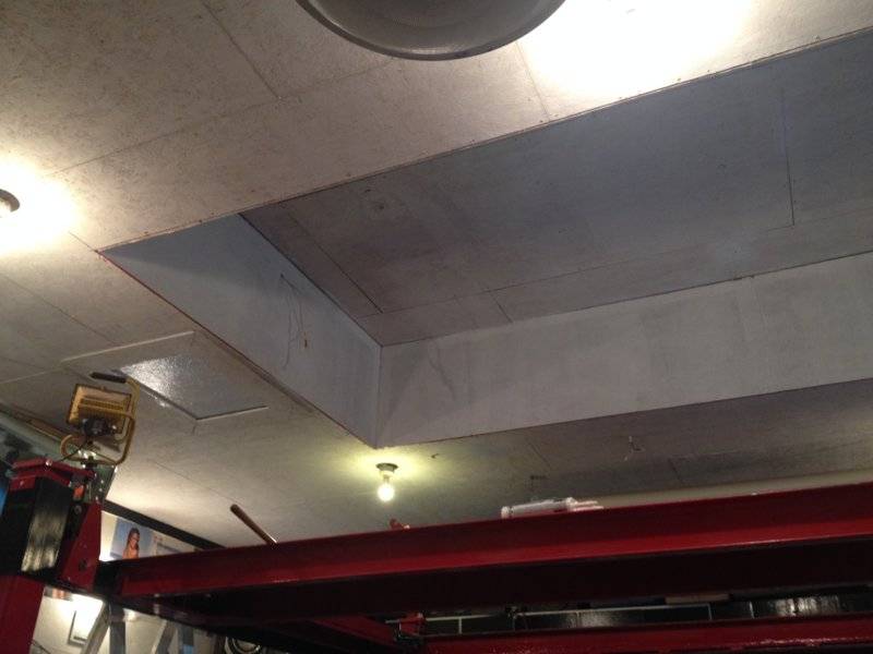

I am 6'2 and can walk under mine
13'6 ceiling height
I did this. 32” to get just over 13 feet. Full size van on hoist and i have lots of room under hoist.
My pickup at full height is too high to work on.
