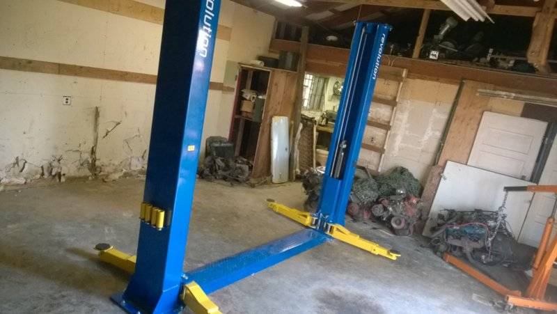

I did some research and went with Rotary's consumer brand Revolution. The biggest difference between their pro and consumer lifts is the pro ones go up and down much much faster, which is important in a pro shop where time is money. It is engineered to be solid, so if you have a car up on locks correctly it's no problem for the lift to support it safely for storage indefinitely. If there were there would be something wrong with it. (granted a convertible on a lift is another story)
I have a relatively low ceiling - 10' under the rafters - so I went with the RTP9, a low-profile two-post with 9,000# capacity. I can lift an A-body up to the joists and have just enough room to walk underneath with tilted head. I had a local dealer install it, well worth it because they do it all the time and know how to do it safely, and those sections are huge and heavy. The whole thing with tax and installation was 3 and change (3200 if I recall correctly).
Having a lift is the greatest thing ever for car work, I've wanted one for years ever since I was a kid and worked in a garage. Really grateful I have one after all these years.
