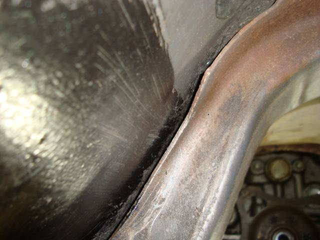

Did you reinforce the cross member on the top side?? There was a factory gap on my car that let me tap (small hammer) some 1/8" plate between the body and the cross member which compensates for all the cutting.
Treblig
The passenger side was more of a hassle than the driver's side when it came to trimming. I think I cut a nub that sticks out on the passenger's side of the trans and also had to trim the cross member a couple of times. Seems like the higher I got the trans to go the more I had to trim off the passenger's side:
I did, thanks to your info. In my restoration thread you can see how I did it. The drivers side is perfect. Passenger side I have to trim a bit more, plus I removed a couple of excess tabs from the tranny.

Cuda620 - here is how I trimmed my cross member. I didn't just cut it out, I welded some 1/4 flat bar in place of the cut areas to make up for what I cut out. Should be good to go but I plan to triangulate from the new trans mount / subframe connector to the cross member just to be safe
That looks pretty nice!!! Should hold up real good! It's pics like those that help everyone!:thumbsup:
