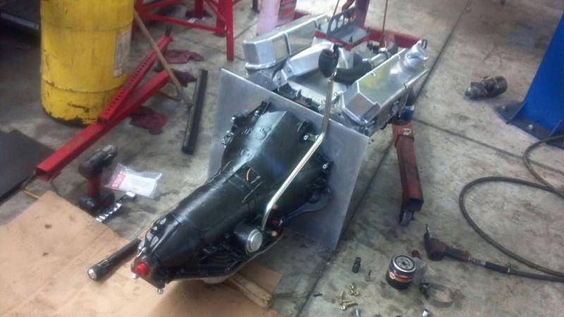

Mine came with the TCI adapter. I huge square piece of billet that was drilled for all the proper holes, but not cut to shape. I mounted the motor and tranny on the floor, sprayed paint around it to give me the form and cut it down myself.

I had the convertor builder add 3/8" to the three convertor mounting pads because the wilcap set up makes you have to pull the convertor too much towards the engine which doesn't give you as much pump engagement. With the extra 3/8" on the pads you get full engagement of the pump splines. Treblig

Mine was cut off with a sawzall and grinder. It was not machined, but it looks like it was. Way too much trouble to get it tooled up to machine unless you send it to Lonnie.
