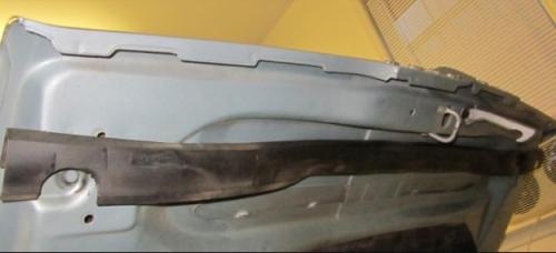

Anyways, thanks to all those who contributed! Here's a photo of my make-shift hood seal. It's a perfect fit and a cheap way to test to see if it helps!
Thanks for the visual MobileCustoms. Cheap and simple - I like it!
