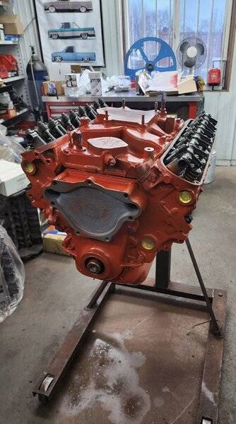

One head and the oil pan from some forabodies friends. We should be dropping this original 273 commando back in the 65 Cuda soon. Still a ton of work to do but it's coming along.
I'm glade the oil pan worked out for you. I guess you found the head you needed sorry I could not be more help with that. Motor looks fantastic. I hope the rest of your build goes smoothly. Mike
