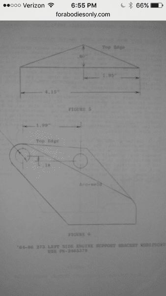

Actually, both sides are different. The driver's side 273 mount can be used on the 340 by adding a ~5/8" spacer between the block boss and the mount bracket on the top rear mounting lug.
On the passenger side, two bolts will line up (and I have seen cars running just those two bolts), but a triangular piece needs to be welded on and drilled for the third mounting lug. Sorry, can't come up with a pic of that at the moment, maybe someone else has one.

motor mount blueprint

The diagram in post #7 is not correct for a 64-66 273 bracket. It's in the Mopar Performance manual since forever, but it's wrong. That's a 67-up bracket. For 64-6 bracket, just fab a triangle that matches the opposite side and weld it and you'll be good to go. Pic:
Driver's side bracket, you can fab a spacer, or just use a few washers. Viz:
