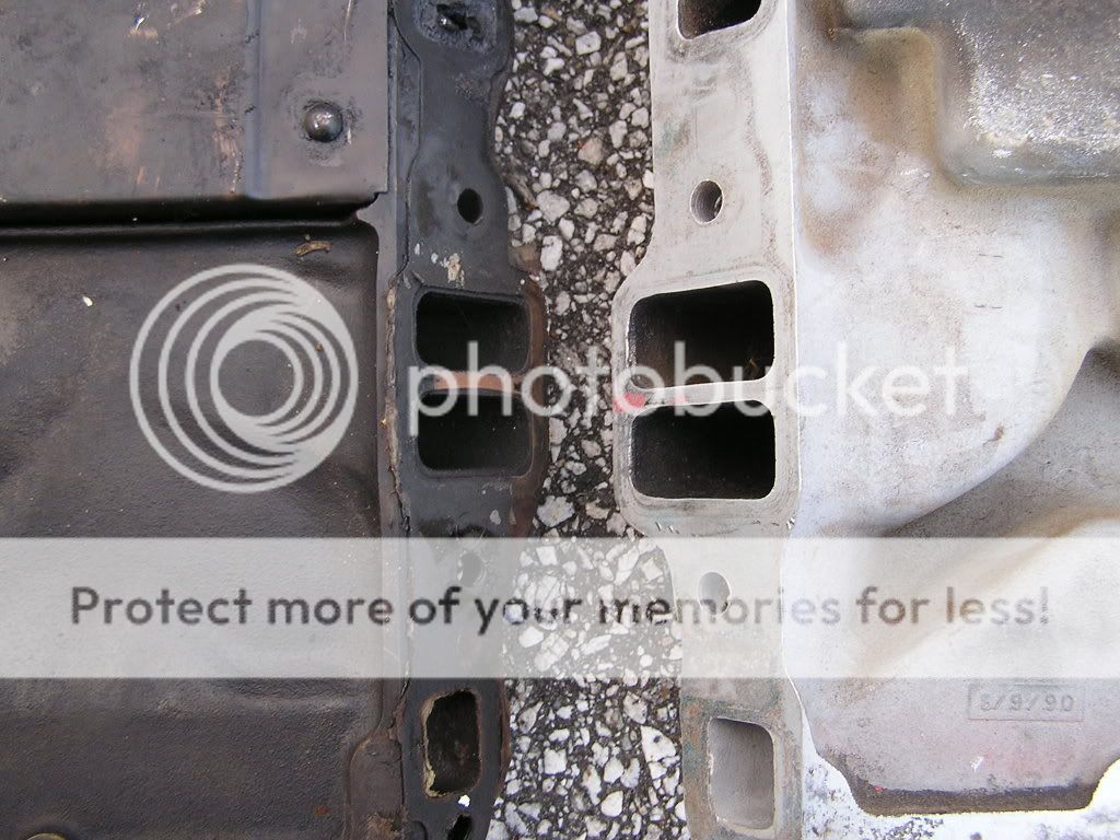

As promised. The Holley Street Dominator has 273/ 318 small ports so the Offenhauser looks more promising with 340/ 360 heads, although it is a bit taller. You can see the difference in ports between the 273 and Offenhauser intake.
Sweet, thanks 66fs for the photos. Thats a nice resource for me :)
