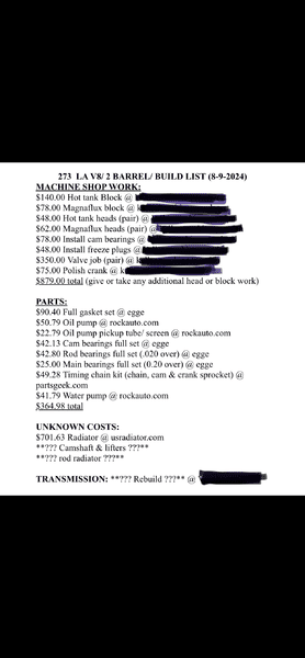

With the 273, The machine shop put me at $950-$1100 for tanking, magging and cleaning the heads and block, also includes valve job (give or take additional work or parts needed), installing freeze plugs, installing cam bearings and cam (when and if one was found without other major costly modifications) that’s a rough estimate and description… WITHOUT machine work and reusing the existing piston rings, wrist pins and the like, no boring either, they suggested a new cam and crank… (both rusted and pitted) then a rough estimate of $350-450 in additional parts… rod and main bearings, oil pump, water pump and so on… they did mention difficulties in finding head gaskets (.040) and a few other concerns… this still leaves with either rodding the original radiator at unknown condition or $700 for a new one…
So, please, if you have the time and patience, educate me here with my options and how or why I should take on the 273 or the 318 or a magnum or any other ideal solutions and how to solve the transmission and or exhaust and rear end concerns, if any, or anything else that I might be missing.

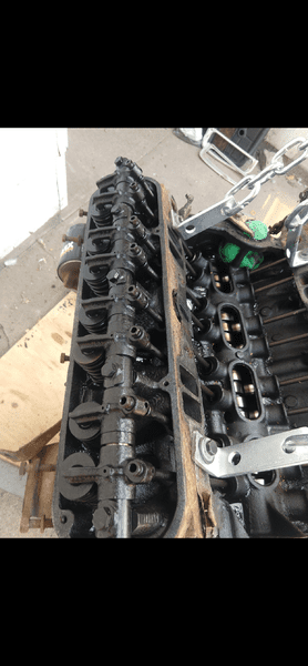

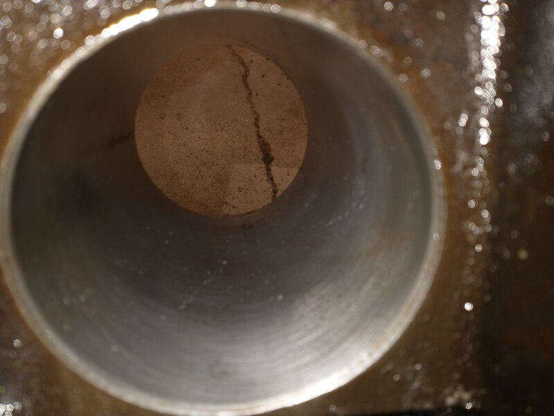

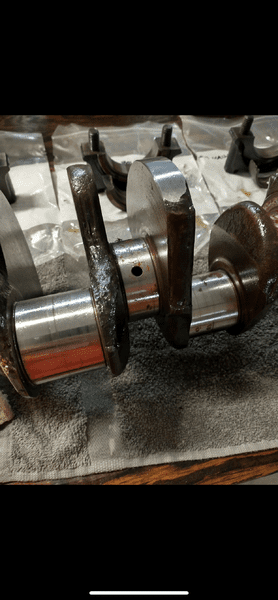

Here are the pictures I was trying to add, it wouldnt let me attach them in our North Dakota thread. That’s a GENERAL costs list from a local machine shop for engine/head work and a general parts needed list, I didn’t want to drop any names as not to disrespect anyone, and pics of the crank as is when removed and after a little in garage cleanup.
you can probably add 350 to the machine work bill on the heads for new hardened exhaust seats, and probably a guide or three, and unforseen things and stuffs. a new crank isn't all that difficult to source, so the cost of that (free~$150) + whatever they need to do on that (hopefully just a polish). then cough up $700(?) for pistons and rings, plus a bore and hone at i'd guess another $400 unless you can get away with just a hone and rings. if the rods need resized? there's another $200.
double the price on the waterpump and timing chain to get actual decent parts that will last.

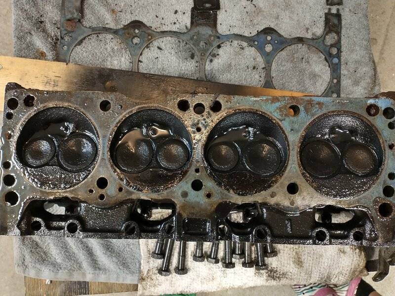

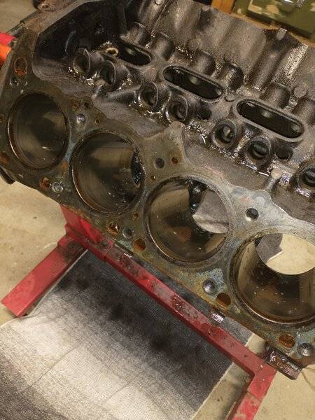

Good advice I appreciate the input. I’m hopeful for a hone and rings, after its rebuild in 85 it was not driven much thereafter. Still clean clear crosshatch in the cylinders. So aiming to use my pistons and avoid any unnecessary machine work. I’ll call a few shops and see about having the crank polished. And yes good point in higher quality parts for water pump and timing set. (There was very LIGHT surface rust in some of the cylinders, I know rust is rust, it washed right out with some PB and a maybe a minute of cleanup with a scotch pad)
that doesn't look too bad, you could probably get away with a quick stone hone and some rings. but if you're thinking about reusing that crank? that's gonna need cut for sure. i'd be suspect of anybody that said it'd polish out.
anyway, what's the deal with the heads? are they the early ones that have the specific angle of the dangle on the intake bolts or are they later ones that'll take all the intake manifolds? and are they in decent nick? cuz you can spend a mint on heads and wind up right back where you started.
part of doing this is making sure that the good money only spends once!

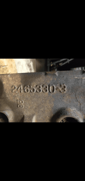

Fairly sure the heads are early, angled bolt holes… block cast is 65… I do not know they’re exact condition I haven’t heard from the machine shop on them just yet. Few pics below. Again this was my dads everyday driver and was only parked because the trans reverse went out. Rebuilt in 85 and parked in 89. I can only hope for the crank, if it’s toast then I’ll start networking in finding one.
verify verify verify.
while the early heads may be entirely serviceable, the problem is that you've hemmed yourself into only having a select, tiny, limited amount of choices for an intake manifold-- the 2bbl you have, a factory 4bbl if you can find one, or if you want to open your wallet wide: an edelbrock, offy or i think there may be a weiand option. and even then, they're also tough to find and expensive.

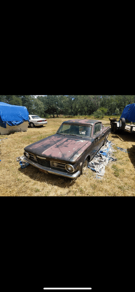

Hello everyone! Thank you to all the members who took the time to read and contribute to my previous thread regarding my dads 273 and the cam options.
I just had a 2 hour conversation with my dad and it turns out that there was a critical missing piece to the story that had NEVER been revealed to me.
The 273 in my dads barracuda (the engine that I have now and was trying to refresh) is NOT the cars original engine and therefore is NOT the engine that he worked on and learned to wrench with. Having said that, he made it clear to me that he had no sentimental value to THAT engine and gave me his blessing to looking into swapping the engine for a healthier and more financially comfortable option. I’m thinking 318???
So, moving forward. Being that the crank and the cam issues alone on the 273 are presenting issues, cost for machine work, difficulty finding head gaskets, camshaft solutions without other costly adjustments and so on, I am here to clean the slate and look for opinions, experience and education to putting in a 318 instead and what transmission?
Again. My current setup is the following: 1965 Plymouth barracuda V8 with automatic A904 (cable shift)
The costs and difficulties, for me at least, with the 273 has put me in the position of, is it true in saying that a 318 is a healthier choice as far as parts availability now and in the future, cost effectiveness for the build and potential for a little more build options being able to look into the 4 barrel vs the limited 2 barrel on the 273.
Also, how would this affect the existing 904? Which btw has a “broken reverse band” and will need repair/ work. Would it make more sense to find and install a 318/727 combo?
Again, I am lost here and only looking to build a safe, road worthy car that the family and I can enjoy for some car shows and weekend driving. NO hot rodding. But if possible and not too much to ask, an exhaust tone worth a little growl would be nice, the kids love it!

The crank register is a small problem. If one can not be purchased, a local machine shop can build one relatively inexpensively.
