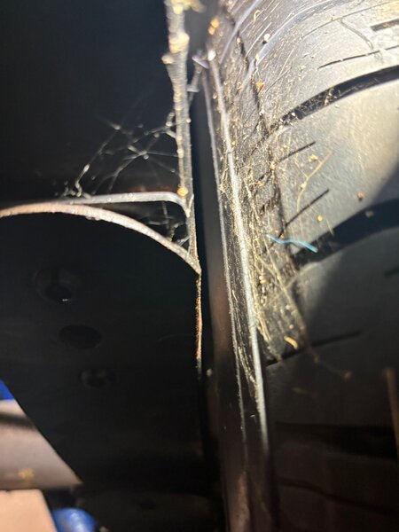

Sup dudes-

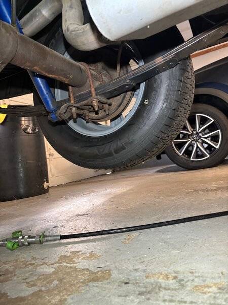

slapped on a set of AR 15” wheels 4.5” BS I believe w/ 275/60/15. Running a 3/8” wheel spacer and still feel like it’s to close to comfort with the leaf spring clamps, removed them for now but need some solutions as I know they serve purpose with traction. My initial plan was to move them closer to axel by an inch or so not ideal but this will not be a drag car.
Springs are Mopar SS P4120863/64 looking to see if anyone ran into this running these tires on 73 Duster, 8 1/4” rear

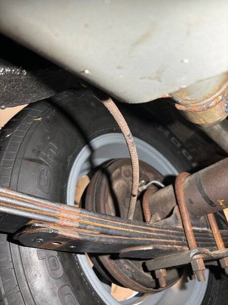

Attached photos, maybe they are just this close for guys running them but to me seems dicey idk- looking for tips/suggestions etc.
That’s without the spacer in the pictures?
Unfortunately you’ve discovered that the 8 1/4 is actually narrower than an A-body 8 3/4. The 4.5” of backspace on a 15x8” works well on an 8 3/4 with BBP axles, but with an 8 1/4 or 7 1/4 you need more like 4” of backspace.
You can move the clamps, but I think you’re stuck with the 3/8” spacers. Upgrade your wheels studs, run an high quality billet spacer and make sure you keep everything torqued.
First, if you have the room to the fender, more spacer. Good quality long studs and a billet spacer. (No cast garbage).
Next, you could move the clamp closer to the axle, (your first thought)
You could also try to drill the leaves and use a bolt and nut in place of the clanp.

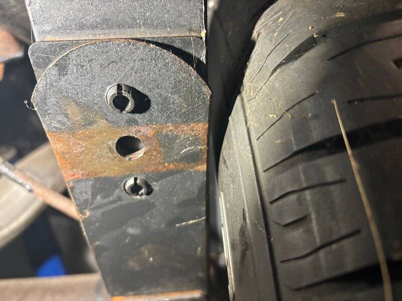

Those pictures are with the spacers?
Yikes. That’s still not enough space, especially with the clamps moved. You run the risk of one of the leaves shifting and cutting the tire.
Honestly I’d get a 1/2” spring offset kit from DoctorDiff and just have the spring perches moved. I personally wouldn’t want much more spacer than you already have, but you still need more clearance.

Actually a lot of people run 275’s on Dusters/Demons/Dart Sports. With the right backspacing they work fine on most cars in those bodystyles.
Problem here is the 4.5” backspace is what you need for an A-body 8 3/4 with BBP axles, which is too much backspace for the narrower 8.25”
I just looked up the dr diff not bad for the price seems easy to do- thought maybe you had to reweld to kick them in but the kit seems like straight bolt in
The hangers and shackles bolt on. The leaf spring perches have to be cut off and new ones welded onto the axle housing at 42” c-c (stock is 43”).

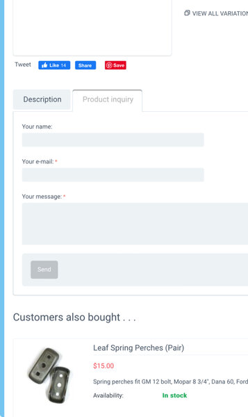

question for you- did doctor Diff make your kit to order? Went on website but was not available out of stock, sent email to them just curious
Doctor Diff the only option for bolt on spring relocation kits with exception to moving in the spring perches? Website out of stock looking for other recommendations that don’t require welding to frame etc got enough going on with this project already thanks
Mopar performance used to make a kit too, they advertise it as a 3/4” offset but the front hangers are only offset a 1/2”. They’re a little harder to install because the hanger isn’t as nicely designed as the DoctorDiff ones
DoctorDiff usually gets his in stock a couple times a year, you might ask when he’s due for his next batch

How much clearance now with the rear wheel opening lip? Seems to me like it would be easier just to buy a set of wheels with less backspace, and cheaper in the long run than buying a pair of 255's and also buying and installing an offset rear spring kit.
Edit, just checked my file because I couldn't remember what my backspace was, but I'm running 275/60-15s on the rear of my 67 Barracuda, 15x8 Cragars SS wheels, backspacing is 4.25. 8 3/4 rear, instead of your 8 1/4, so not directly applicable, but it clears OEM springs and fender lip nicely.

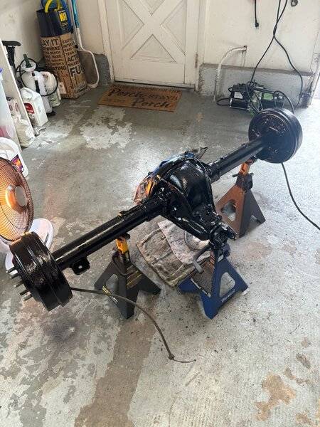

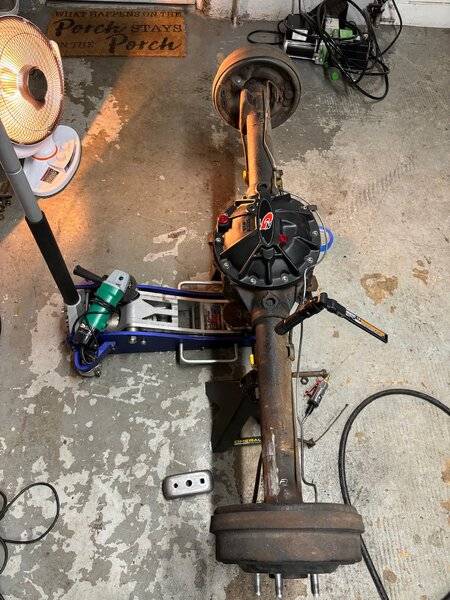

Got the doctor diff kit, dropped rear out welded up the perches and decided to paint the rear while it’s out.
Def will have plenty of side wall/leaf spring cleareance now for the 275/60/15 on 15x8 4.5” BS on 8 1/4”. Rear is going in this weekend and frame ties going on. Now will be ready for the road finally
