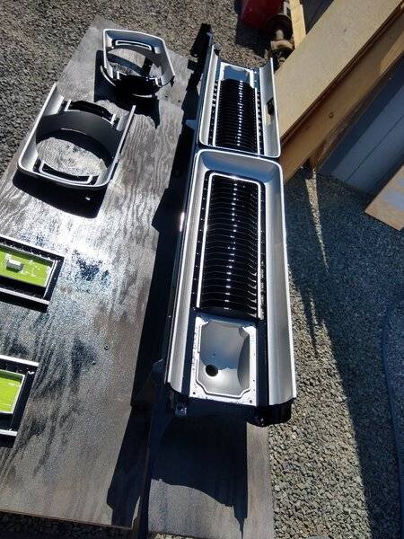

Well, I finished the wiring, which wasn't too bad, really. I got the FItech installed and running pretty descent. I finished restoring the grill, installed vinyl top, put the valances and bumpers on.

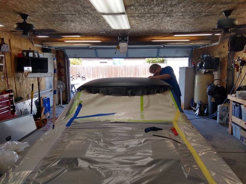

Just going back to where you installed your vinyl roof.. I was just wondering how hard you felt it was!
