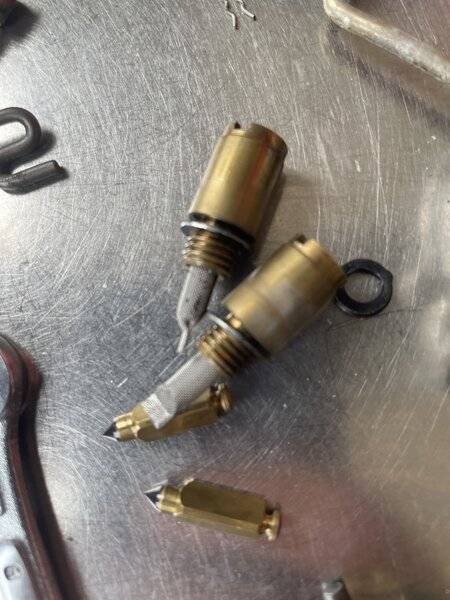

So I finally got out to the garage again, and installed the carb rebuild kit. The pictures are from the “before”. Lots of debris and varnish, but it cleaned up nicely. Couldn’t read the jet sizes, and the secondaries were stuck in place, so I left them, but the rods were a weird size. Either way, the bogging went away, although I also noticed my transmission fluid was a bit low and tipped it up, is it possible it was just a super slow shift?
Now I’m still struggling with timing, and getting the idle mixture set, but those are issues for another day!
I would ditch those little filters in the seats. Just use one main external filter.
All kinds of wtf.
The rods size you could have noted 'if' you pulled them. Secondaries stuck??
Disregard. I was looking at the metering rod thinking it said 1547 and was a part number, but it’s 7547 which is the stock rod.
And yeah, the secondary jets are stuck. If i try to turn them out with the right size screwdriver, I’m just stripping the groove in it. It’s the stock jet, so I left it. Cleaned as best I could without pulling it.
