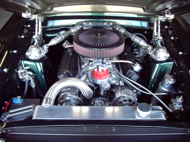

It's alive!!! Finally ran up the engine today, so far so good :) The reeds do an exceptional job. Engine starts on first turn of the key, even when dead cold.
Nothing wrong with proper re-enforced, fuel specific rubber fuel line. Good enough for zillions of OEM fuel systems, then its good enough for me.
Well you told me……you go ahead and have at it with your cheap *** fuel line that looks like **** then…..:banghead: I wouldn't use it on a lawnmower. Lol
And you know your ends aren't flared either, you did the slipdieee dipdeee. Big no no
You should not assume because the ends are infact flared. I own and use a press flaring tool. Every hard line to soft connection I do on every car I work on has a bubble flare behind it. I don't see how you can call quality rubber fuel line "cheap ***", but then again you could be one of these guys who puts braided line to his windscreen washer bottle hose.. :) Spending big bucks on blingy braided line that doesn't "look like ****" doesn't make you more professional, choosing the right part for the job does. Most times it's total overkill for the application.
The cut carb feed line is only there to make it easier for me to do some tuning. It's actually the one I've used on other engines to do this over the last 10 yeas or so. It is also bubble flared at each end under the rubber line. Once I'm happy with the tune it will be replaced with a hard line.
Right on. Black rubber hose/line of any kind is just fine for its specific and intended use....looks sano IMO.
Save your $$$ for the parts that really matter.
Build on.....it's looking sweet. We need some vid.

So far so good, no oil leaks etc. I won't be road testing it until the paint is done, as the car has no front end or seats etc, in it.
The reeds I bought from ebay. They were for large Evenrude , Johnson type outboard motors.
The car is waiting second in line, I just have one other Mopar in front of it that I'm in the middle of painting at the moment. I should get to it by November.
Also I think I'm going to paint it in the color scheme of Dick Landy's Dart.

Hi, Yes, you will need a turbo with a seal to stop it sucking oil past the shaft and into the compressor housing when it's under vacuum.
I'd have to think that the fuel being added upstream would cool the charge down.
I think I've got a map for this turbo somewhere , I'd just have to find it. It's a Rajay 300E turbo. Still supported because it was used on aircraft as well as auto applications.
Sure, I can't see any reason why you couldn't use it as a twin setup.
