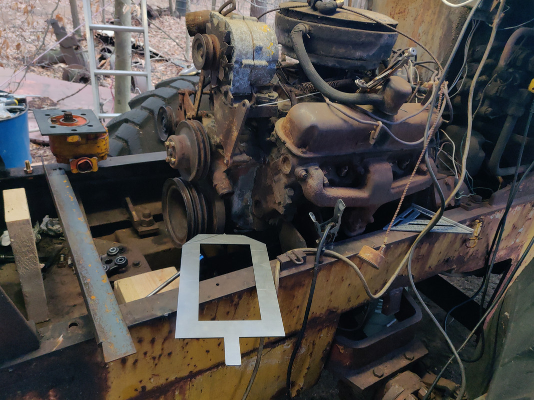

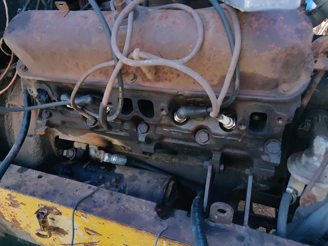

Here we have a mid 60s LA 2 barrel thats been mocked into a mid 60s Hough50 series payloader. Done in the early 80s. old and tired, and had over 100k miles on it when swapped, but this 10ton machine and the high pressure hydraulics can be grumpy to move and pump oil. After the swap this motor had some serious hard hours for 30 years moving material starting before and ending at dark. That's an oil bath air filter as well.
Uses the orginally international starter through a custom bell housing out of some quarter plate. There's a torch hole on the other side where the dodge factory location wasn't going to work. Apparently the rotation was wrong? Maybe? so the oil filter was the sacrafice. Good ol' add-a-hose. Oh, that's a 55amp externally regulated Remy GM charger on there. Unfortunately I'm keeping it, the accessories and belts are already perfectly linesd up. Not sure if I can do the self excite trick on them older 2 wire Remy's?
Pics or it didnt happen, right?
Yes, I personally parked this machine a few years ago, and is in the process of new ignition, charging, wire loom, hydraulic pump, rubber hoses, tires, and I'm deleting the coil ballast for the newer style coil. It'll match whatever was welded shut on the head between the plugs....?? I plan to stay points. I found like 10 spares in the shop.
Anyways, yeah, there's less of us everyday.
Enjoy!
