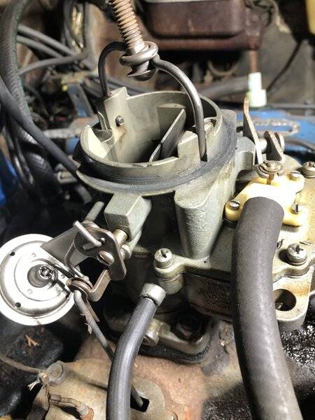

Yeah been busy just got the car Monday. I did confirm good spark and replaced the ecu and ballast resistor just to be safe. Also found the crack in the pcv hose replaced that. Maybe it is a stuck float then. Carb is a Carter 2 barrel. How would I go about checking for a stuck float? Tap the carb with a block of wood and hammer?

The needle and seat unscrew right from the front of the carb, where your fuel line goes in. Couple of wrench's, it's out in 30 seconds
At this point I must agree that you have carburetor issues. What kind of carbuertor is it again?
When it comes to thise carters, if one thing dries up.. the rest is probably needing replaced, carb gaskets, seals, and most importantly for goosing a cold start...the accelerator pump plunger. When that goes, it kills the rpm upon opening the throttle..dead spot and it dies. I bet it just needing an easy carb overhaul.
You can also just raise the idle speed up to help it run for now to prove its faulter, but it seems almost certainly the carburetor is the problem.

Ok needle and seat looked ok to me. Car had a new gas tank installed last year according to the paper work that came with it.
There wasn’t a lot of fuel that ran out when I removed needle and seat. When u shake the car u can see the fuel in the carb though and some ran out. Looks level with the threads

Of course it looks good "NOW". Consider the DUMP of gas that's gone down the intake before you looked at the float level. I'd get those floats out and check them closely. I bet you'll find them compromised.
Does anyone know where I could get a new carb or rebuilt one that would be a direct replacement for this carb?
